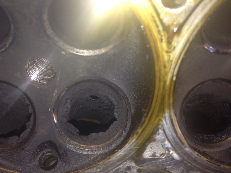

Originally Posted by genik
I checked the video on the Bavarian Autosport website but i must say its not clean like it was from day one. The walls of the valve chamber are not 100% clean, they don't have the silver metallic color that they must of had when the car was new!
The ports will never be back to a factory state of color. The oil will stain them. If you dont wanna spend the money to walnut blast them. Its gonna take forever. The fastest way is the walnut blast, then do the rest manually. Theres a good reason for doing it that way. Around the seat area it build up. And if you clean it manually those pieces of crud will drop into the cylinders. Heres how bad it can get. That area around the seat you will play hell getting to manually.
Heres how bad it can get. I highly suggest walnut blast first then do it the hard way.
Attachment 107959
How long does it usually take to get to that point? Most places and posts claim around 30K. Would one's driving style can prolong its service interval or is it regardless?
Reason being, I do 120m/day 95% freeway driving no stress unless if I hit traffic due to construction on occasion. Last time I had it done was last August and never before that. I am at 124.8K on the clock as we speak.
Thanks - jg
Thanks - jg
Every Mini is different, but freeway driving is the best for prolonging the buildup of carbon on the intake valves, city driving and driving your Mini hard stop and go will only increase buildup. My carbon buildup on my intake valves was surprisingly mild for the 47,000 miles driven, it's possible mine was clean before I took ownership of my Mini at 45,600 two years ago. It's also possible most of my miles were on the freeway, I always drive hard on freeway on-ramps to open her up and clear her throat.

Well, that photo was taken at around 150,000. I got the car at 110,000. Not sure when the previous owner had it done prior to me. Ive always seen recommendations to be done every 30K. My car was all interstate miles. Theres alot of speculation of do this do that. But everytime the end result has always ended up being walnut blast it at 30k and theres never any issues for the people who've had it done on a regular maintenance schedule. Its like changing oil, just one of those things on these cars thats gotta be done whether we like it or not.
Thanks! That goes for brake and rotors too... and possibly oil change intervals where viscosity breakdown is prolonged.
Sorry if I am off tangent from the main topic.
The picture posted looked horrible. When I had my car serviced I have to live it at Helix for a couple of days since I had a few things done also. I should have asked to take a pic of the before and after to see where my driving habits and style contributed to it.
YES on preventive maintenance! But the walnut blasting is such a big deal (at least me it's a huge undertaking because of proximity) that between driving habits and styles if I could get an exact schedule when to get it done.
Now when you get it done at 180K you can exactly tell by comparison just for casual reference.

Heck yea you'll if you wait that long. But dont do it. You just gotta figure out what schedule works for you. Only you know and can answer that one. So if i were you. Id get it done. Go about 20,000 and look it. Maybe go some more. Look again. You gotta make a schedule up.
