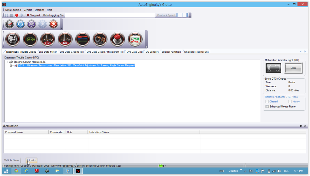

You guys know if AE can be used to CODE the new SZL?
It went though a recognition process after I installed the new SZL but then I couldnt figure out how to calibrate the steering angle.
AE's BMW extension states that you must be in LIVE DATA mode to "actuate" anything but I never saw an option for "actuation" while in any of the live data screens.
After I installed the new SZL I got this in the diagnostic trouble code screen:

Did you find an answer to this question? I'm adding cruise to my Mini and require a new SZL. I'm wondering if I'll be able to reprogram the steering angle??

Yes it can calibrate angle but cannot program a new szl. I confirmed this with Autoenginuity.
You must program the SZL first in order to be able to calibrate the steering angle. Car doesnt recognize the new SZL until its programmed to the car.
Bring it a BMW shop and have them program the SZL. At that point they will calibrate the the steering for you since its a tiny additional step.
They charged me ~$100. Im sure it took them 15 minutes.
