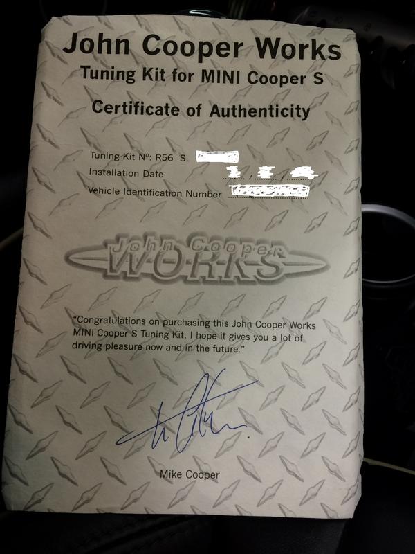

What makes a Mini a JCW Mini?
So I here and see allot of people say they have a JCW Mini. Specifically a MCS. So what exactly makes a Mini a JCW Mini? Can someone say they have a JCW Mini if they slap on some JCW rims only? Or can they say they have a JCW Mini if they slap on a JCW body kit?
I seen a posting on Craigslist of a person selling a "JCW MCS". All that I seen that was JCW related on the car was some floor mats. That's about it.
I own a 2007 MCS. I have JCW R105 rims, JCW Aero body kit, JCW mats, JCW Tuning Kit and so on. Can I say or claim I own a JCW Mini?
What say you guys?

I'd say the biggest thing that makes a "JCW" a "JCW" is the tuning kit.
Lots of added "JCW" stuff does not make one a "JCW". (I have JCW seats, wheel, and interior trim...).. I'd never say that "I own a JCW" nor would I add external badges to my car saying so.
JCWs come in two flavors - Factory JCWs (FJCW), and built JCWs.. "Built" is subjective. I'd love to get the body kit and tuning kit.. If I had them with the interior I have I'd say I would have a "built" a JCW.

Per MINI's own definition, any Factory JCW or Cooper S with tuning kit qualifies as a JCW.
I agree. The tuning kit makes it a JCW. What other mod/upgrade/add on, or whatever you want to call it, gives you a Certificate of Authenticity from John Cooper Works or Mike Cooper?
