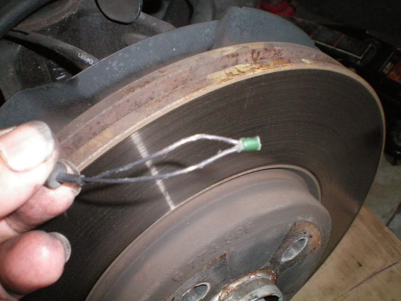

You just cut the sensor off and connect the two wires together. The sensor works by breaking a wire causing an open circuit. Create a permanent connection. I soldered mine with some heat shrink to keep everything water tight, then zip tie the wire someplace safe
BUT your GEN2 has a two part wear warning ... the physical sensor which we just shorted out ... and ALSO a counter similar to the oil change counter. This one is going to continue to guess your brake wear but you can easily reset thru the steering col' stalk .... no problem-o
