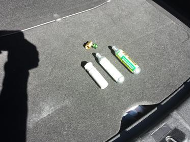

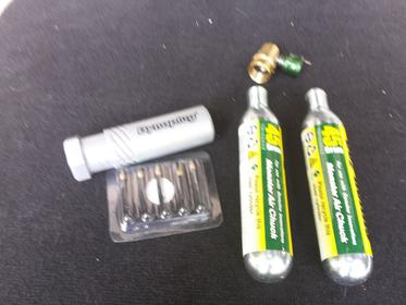

in over 1 million+ miles driving cars and another 500,000+ miles driving motorcycles, I have never changed a tire on the side of the road
I do examine my tires weekly and have found nails, screws, glass etc that would have eventually caused a flat but had the tires plug/patched before it happened
I do carry plugs and a CO2 inflator kit, but no spare and no worries with either my summer or winter tires/wheels, neither of which are run flats
