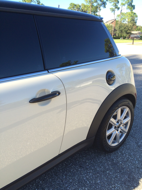

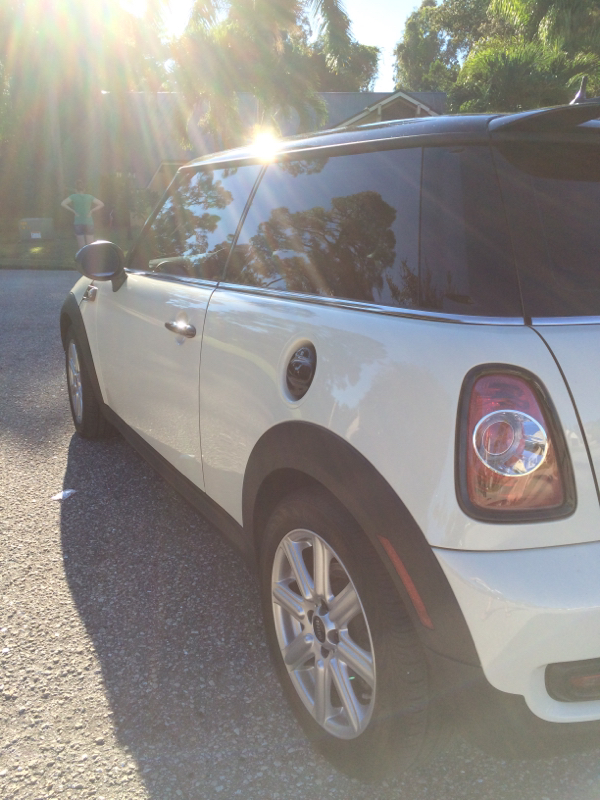

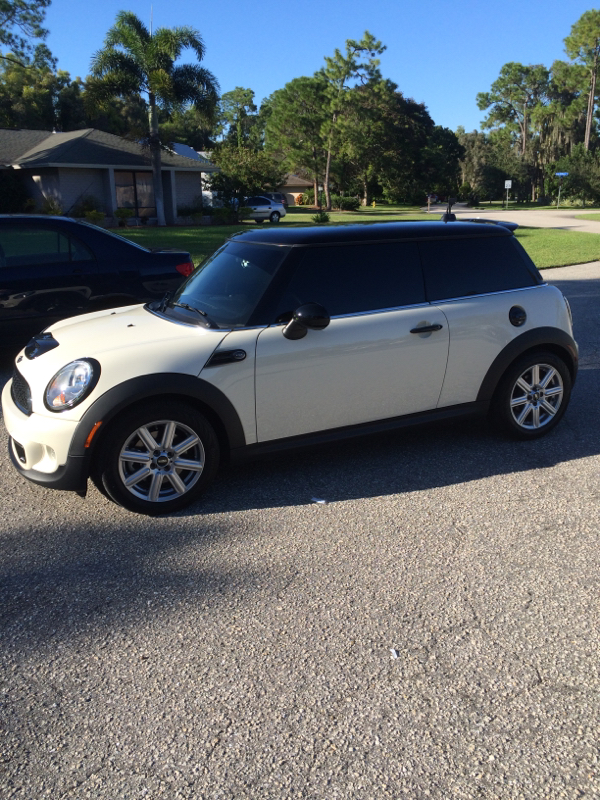

Black out finally complete!

What experience do people have with blacking out the chrome band around the base of the windows? Really want that gone!

Go for vinyl blackout it's what I plan to do

outmotoring sells a blackout tape that tapes right on and is very durable for less than $20. I did it in about 1.5 hours (really gnats assing it) and only used half a roll. Check it out here:

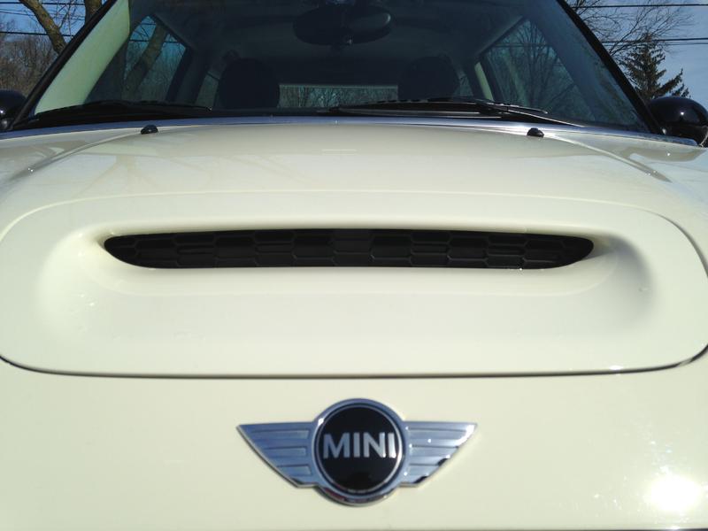

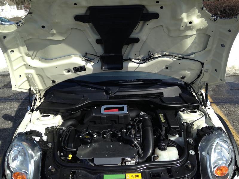

I don't see how Alta can call that a CAI... I have the AEM intake and opened up my scoop to create a functional ram-air intake. It gives me the sound I want as well as colder air from outside. The shield that goes over the turbo does an excellent job of keeping the heat off of the new intake tube.
It's hard to tell, but the picture of the hood scoop shows how I kept the stock scoop grille, but I used an angle grinder to chop off the back half. Normally this is solid with 3 or so small holes for venting (I think)... Now it serves as the actual intake.

^ When I was running the stock hood scoop I just unscrewed the black mesh and ran without it. I used plastidip to cover up the body color behind the scoop to clean up the look.

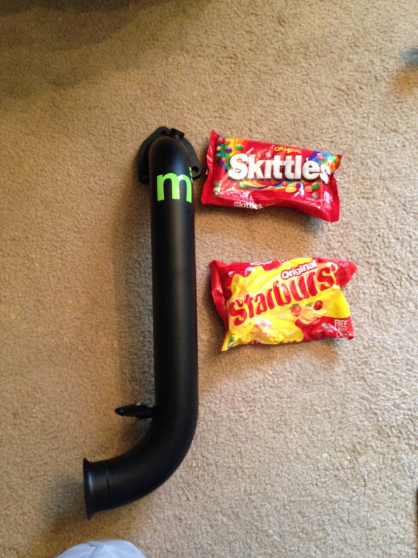

I had my catless DP from Mariokart ceramic coated, which should def keep the ambient heat down a little

Post some pics before you put it on! Love to see it!

Found this before the install! Yea he sent free candy! One of Mario's signatures lol.

Bags full of pops and crackles eh? hahaha
