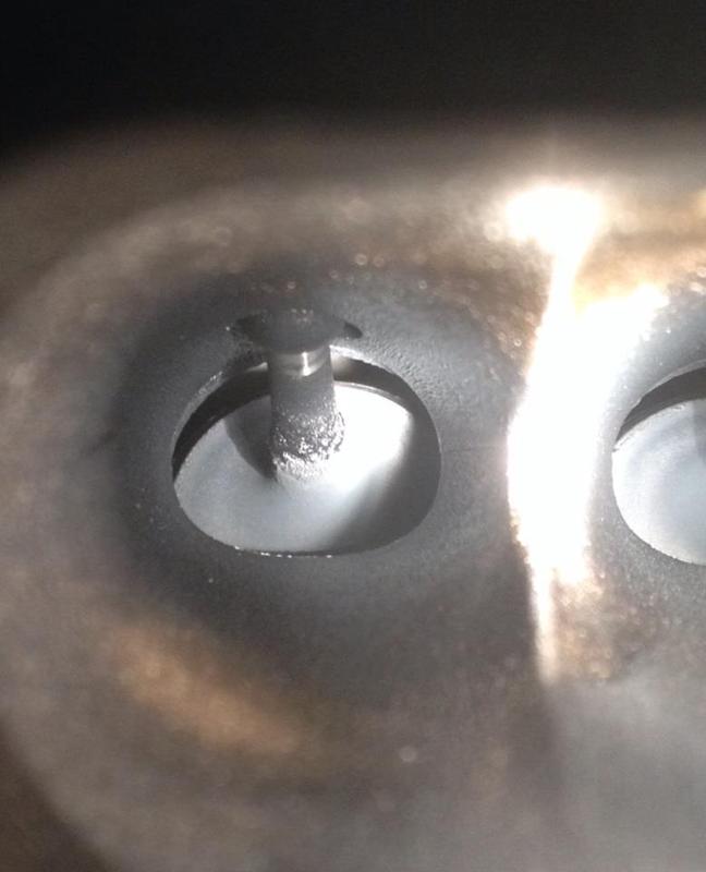

I have heard about bad carbon buildup and seen some pictures of caked valves at ~40k. I figured I would have a look at mine since I'm at 58k and and give them a once or twice over. If the intake was easier to remove I would have said F it and put the intake t back on without cleaning them. Attached is a before picture and they all looked like that.
Attached Thumbnails Is Carbon-Buildup still a problem in N18 engines?-10177962_10201934255985691_4241105722331619479_n.jpg

Velvetcows, that's good info. I agree your buildup is not bad at all, it's much worse on my VW. Do you drive hard or do any track days?

Fantastic!!

wow... thats not bad at all... good to know!

No track days. I drive at least 15 miles one way on a typical trip daily. Average mpg is 28-30 and when I drive it hard it's for 5 minutes at a time or less. I'm not too hard on it but I also push the tach past 6 a lot once the engine is warm... almost every time I drive. No real tune yet. 2nd at 2k through the first bit of 4th at wot is a common occurrence. No lift shifts 2nd through fifth just before 6k maybe twice a month. I was averaging 35 mpg a year ago for half a year
