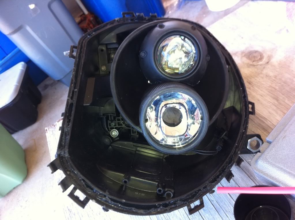

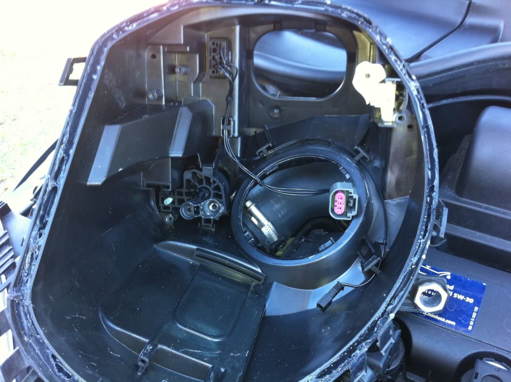

If you like doing unique mods I look at TRS, it is cheaper and will be bringhter, but not OEM.
I have a few pics here to show how it went for me (the first time I did it on my MINI).
Dremeled a little bit out because of this.

First test fit...
Empty housing

Opening and closing the headlight is the easy part, 200F in the oven for 5-7 minutes and patience while prying off. No crazy moves and they come right off. They go back on the same way or even a sunny day will soften them up enough to press back together.
