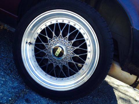

Thanks! So i found out that they're on a e30 318i that has 57.1mm center bore. I found rings on ebay from 57.1 to 56.1 so it should work. The wheels are only $400 with tires on them so I think I might have to pull the trigger on these things

If those are e30 fitment (not iX), then they probably have lower offset (et20) than the Mini fitment, depending on wheel width. I think that the 7 and 7.5 inch wide wheels for Minis should be ~et40 and ~et35, respectively. You may end up with the wheels sticking out of the wheel well or rubbing. If you want BBS reps from an e30 and retain the stock Mini fitment, look for wheels from an iX, which will have a higher offset.

That's a good deal for wheels + tires, just make sure that the tires are not 5+ years old.
And the offset is as cholyoke suggested.
The reason behind that is because the e30 is a rear wheel drive car, and they usually have much lower offset.
The e30 ix however is 4wd, and will have higher offset that will be close to MINI specs.
Now I'm not saying that 20ish offset WILL rub.
Because I've seen 25 offset with the same 225/45/17 on a R56 MINI that didn't rub.
It looked slightly more flush, which was nice
So in the best way would be to go and jack up your car and swap those wheels on.
Both front and back. And see for yourself if they rub, inside or outside, when going over bumps, or when you turn your steering lock to lock while driving.
But I have a feeling you'll be just fine
