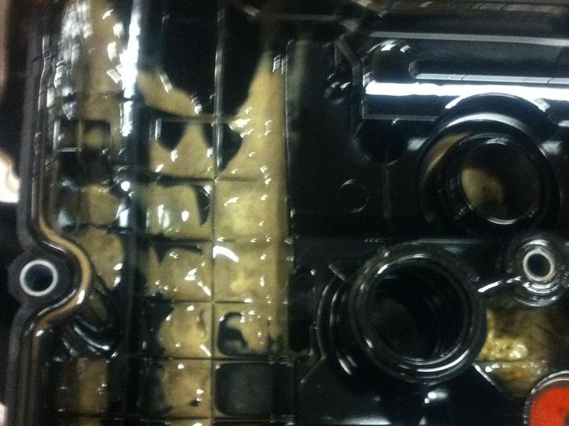

I have my 2007 MCS. The check engine light came on so I brought it to the dealer because I noticed on the cold days when I started the car about a minute in the car idle would drop to almost stalling point. I had this similar issue in Feb and they replaced the high pressure fuel pump. Yesterday they called me saying they thought it was a vacuum leak and they are trying to find it. Today they call me telling me there is condensation under the valve cover because the engine is not hitting its heating point. I drive the car to the train station everyday which is less than 10 minutes away. I don't usually drive it on the weekend because being a family of 4 there is just not enough room. So they called the warranty company and they will not cover this. I ask them how much and they tell me its going to cost $3000. They need to replace the valve cover and some hoses (throttle, sound generator hose etc). I called the warranty company and the claim is for a pcv valve which is not covered because it falls under emissions. Fine. What about the rest of the parts? I asked for a list and this is what I get. I am not really sure what any of this is.
HOT FILM AIR MASS $474.81
RUBBER BOOT $131.41
CHARGE AIR COOLER $331.93
INTAKE MANIFOLD $121.07
INTAKE MANIFOLD $98.99
AIR HOSE $66.17
SOUND GENERATOR $119.50
AIR CHANNEL $42.43
GASKET $6.28
INTAKE MANIFOLD $497.26
THROTTLE $324.60
2461.51
TAX 209.98
TOTAL 2671.49
WITH 7 HOURS OF LABOR
Please let me know your thoughts.[/SIZE][/FONT]

The computer came back with a crankcase ventilation code they said. I don't know what the means and said it is because of the condensation

PCV means Positive Crankcase Ventilation. It's basically how the air and oil vapors that are inside the engine get dealt with. In theory, the oil vapor gets separated out of them, and the air gets plumbed into the intake so that any hydrocarbons left can be burned and won't get out and contaminate the air.
A code will be thrown if the engine management detects some sort of problem in the system. I'm not sure what the detection involves; it may be something like a pressure monitor where they expect to see some specific air pressure during a specific set of circumstances, or there may be something else.
But yeah, it looks a lot like they just want to throw a lot of parts at the problem and hope that it goes away. I wouldn't be paying them to do that.

Truthfully I'd say to replace the valve cover since the PCV system is integrated into the valve cover, and go from there. If that solves your code, then just take the intact tract apart from the fresh air intake to the air box and clean the insides and the filter.

Thanks all. I had to get the managers involved. Now they are looking the car over again. Right now its pcv valve and gasket. We will see what update I get tomorrow.

Is it water vapor creating a mocha looking sludge buildup in the upper cylinder head/valve cover ? Oil changes are based upon mileage OR time. If most of your driving is very short trips of 10 miles a day for last 33K miles, moisture is not evaporating from the engine oil since it never reaches optimum running temps for any length of time. Moisture also degrades the ability of the oil filter to maintain proper flow and can reek havoc on the PCV parts. You should be changing your oil every 5-6 months just due to your driving habits posted here.
That said, any components in that system may need to be replaced. I would start with a fresh oil change. Then the valve cover since the PCV's are encased inside it, then move from there to checking the vac pump for proper function. Poorly working vac pump ( about $480.00) will kill these engines pretty quickly.
