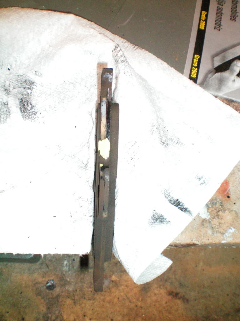

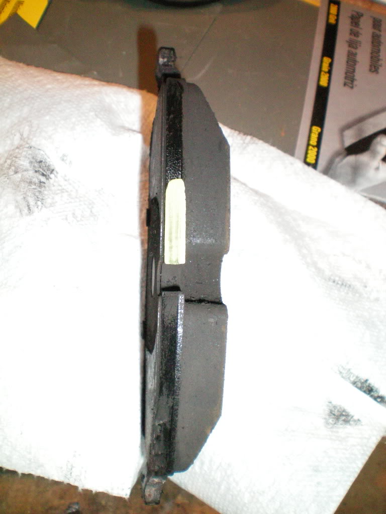

Here's a picture of a nearly new GEN2 MINI front pad. I put a little white paint on the backing plate to make it show up

Here's a worn pad with similar white

Note that the wear sensors are only on the left front and right rear wheels, and then only on the inner pads. I find them pretty useless and have jumpered them....
btw on the good MINI pad you'll note the edge bevel .... now look at the worn pad ... for these MINI pads, if you can see bevel you'd appear to be OK ... no bevel = time for new.
