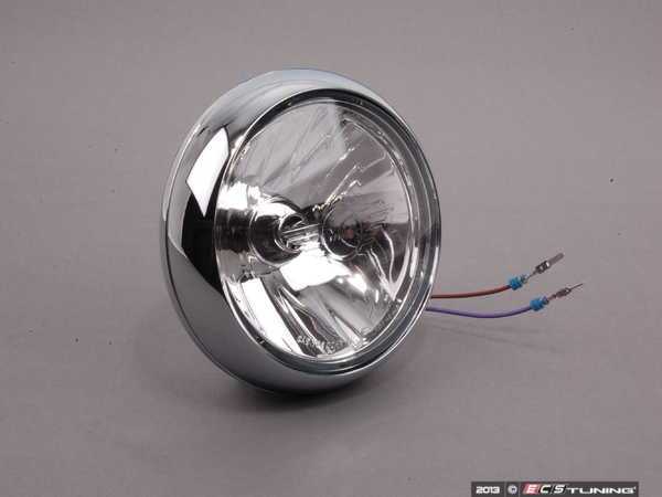

Here is the one light housing "In Chrome" to compare. R56+
Driving Light Lens Housing Chrome Part number 63120417670
http://www.ecstuning.com/Search/SiteSearch/63120417670/ES172118/
