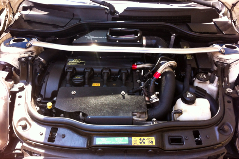

I have the DDM RIS, the GT Spec strut bar and the M7 turbo heat shield. Great combo!!!! No complaints at all...nice intake temps even in NYC traffic.
