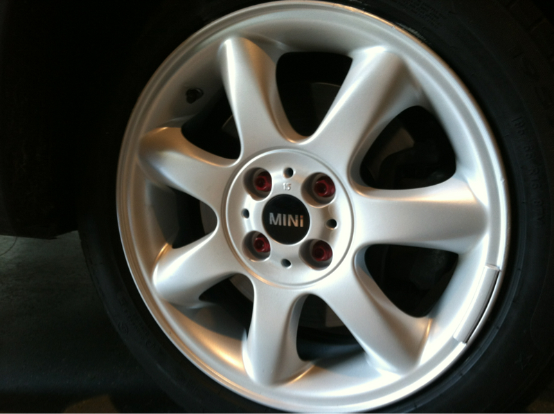

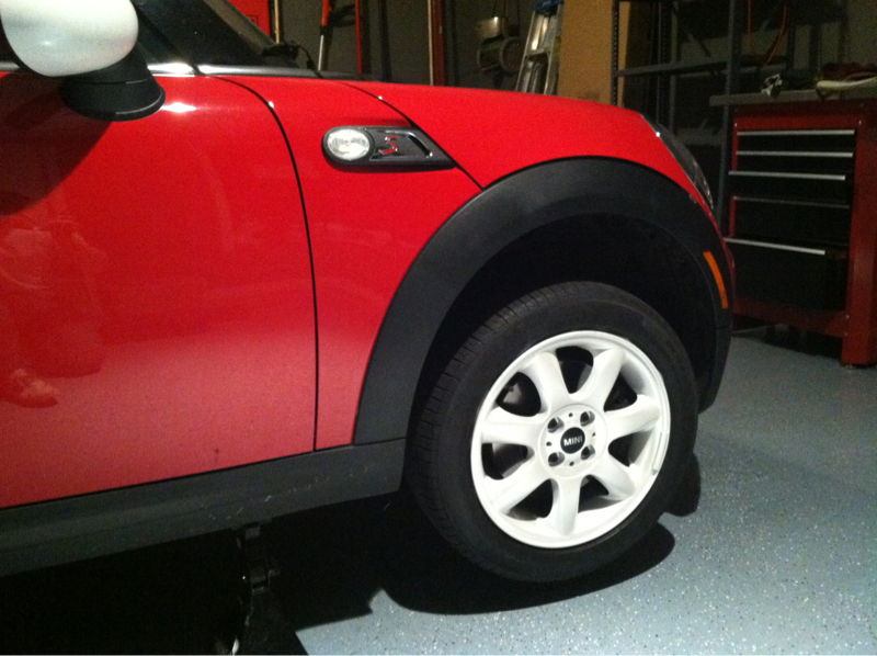

How do ya guys like my plasti dipped pearl white bridgespokes???

Good look, did you do this with the tires unmounted or just tape it off? How well will it stick to the wheel balance weights?

The plasti dip is pretty easy, i used index cards to block the paint from the tire (worked great) the paint sticks really really well to the wheel balance weights, they have kind of a rubbery texture to them because the plasti dip is just a plastic rubber compound so they are more difficult to clean but not that bad but you can use just soap and water cleans them up pretty good, so does the power washer from your local car wash, but they're very durable no chip or scratches even when power-washed, and its been about a month so far, i did the white with the pearlizer overcoat, you can buy the pearlizer from www.dipyourcar.com. I did use 4 coats of white dip, and 4 coats of the pearlizer, i think 3 coats of pearl would have made them a little brighter i hope i've answered everyones questions! Haha if any just comment! ( by the way, i HIGHLY recommend doing this because if at any point you change your mind and want a different color, you can peel if off if you try, but it wont peel by itself!

I bought 4 cans of white an 4 cans of pearl and ended up with a little bit in each of the whites and one whole pearl so i would stick with 3-4 cans of base(white) and 3 cans of pearl
