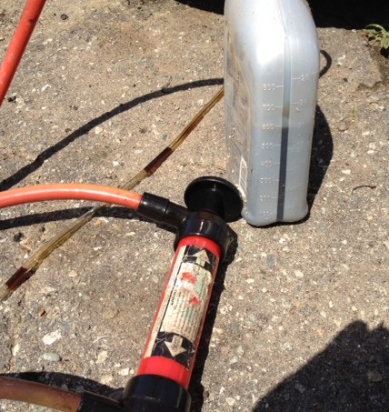

When this happened to me, I did some internet research, and asked some mechanics. The upshot was that it is not an issue as long as the oil is not getting foamed up by the crankshaft, and then draw foamy oil into the system which would create pockets of air.
Everyone seemed pretty confident that ONE quart would NOT cause a problem. It would take a couple of quarts to do it. There IS some room for error built in to the system, some breathing space if you will.
I went out and used a cheap hand pump, inserting it into my dipstick channel, and pulled out oil until it showed the right level. Then I cleaned that pump and sat it where I could use it next time if need be.
The hand pump was only about $6 and we had to add a little adapter and smaller rubber hose for the end that sticks down into the channel, so maybe $8 total.
If you clean it, it will also be useful for things like pumping the last of the water out of a toilet before you pull it, or out of the washing machine if it breaks and you need to drain it.
You might want to buy one, it's an investment in peace of mind.

How many quarts does it normally take to fill an engine like the I4 Mini engine? I put 5 quarts of oil into the engine, I'll make a guess depending on how long other's allow for the oil to drain and say 4.4 gallons, I mean how much oil is capable of filling up the oil pan to the top?
As for the reading I got from minimum to maximum was very linear, adding a little more each time brought the oil level up to the max line. It's hard to believe that a 1.6 liter engine would need more than 5 quarts of oil. What is this about oil consumption, where is the oil getting consumed?
4.4 gallons?
MINI's internal technical service document lists oil capacity by motor.
N12 (2007+ MINI Cooper) and N16 (latest motor) – 4.20 liters / 4.4381 quarts
N14 (2007+ MINI Cooper S) and N18 (latest motor) – 4.20 liters / 4.4381 quarts
Oil change tips:
An oil change is not hard to do but done properly it will take a long time on a R56S.
To drain the oil out of the motor the oil needs to be warm. To change the filter the coolant and turbo needs to be cold. I drain my oil when the oil is warm (let the car sit for 15 min after a 15 min or so drive) and remove the filter after I rotate the wheels (clean them at the same time) from back to front and adjust the tire pressure. Then the motor is cool and I don't burn my hands and all the oil drains out of the filter. The pan is empty except for the part that is trapped in the low part of the pan. It takes about an hour.
Make sure that you have everything that is required for the job before you start. Nothing is more frustrating than emptying your oil, only to find out that you don’t have a replacement filter or enough oil. You will need an oil filter kit, a 10 mm socket, a 27 mm socket, a new drain plug crush washer, an Allen key set with an 8 mm, a roll of paper towels, a very large oil pan or bucket, and 5 quarts of approved synthetic oil. Make sure you get A 27 mm 6 point socket for removing the oil filter housing.
Filling
When adding I take my time. At around 4 quarts I start the motor to charge the new filter and prime the pump. When adding the last .4 I check the level about 4 times (fill some and check, add as needed). I wait about 5 min (with the stick out) between adding and checking. When the oil is cold the level should be about 85-90% full on the stick (don't add more). Check the level when the oil is warm using the proper methods. Make sure the car is dead level when checking the oil level.
