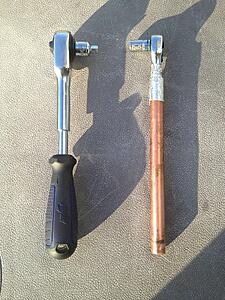

Well that was the most time consuming repair and/or removal and replacement job I have yet to do on the car. Like everyone had said it was not hard at all, but it was definitely labor intensive. After it was all said and done it took me a total of 7.5 hrs to complete. It was 4 hrs of disassembling the heat shields and downpipe. (So bolt locations were really tough to get started and then you had to get your hands in locations that didn't allow for tools and use your hands to work out the bolt.) 30mins for removal of OEM infeed line/OEM return line and reassemble of Detroit Tuned infeed line/OEM return line. 3hrs for reassemble of heat shields, new down-pipe gasket, down-pipe, and new exhaust v-clamp.
I would definitely recommend these two specific tools:
The left tool is a Kobalt Double Drive Rachet. It allows you to use a rachet like normal, but then in tight to reach areas (like you are going to have when working in the MINI and not placing the car in service mode [removal of front bumper]) it allows you to twist the hand left or right to rachet away. It is a great tool and I used it a great deal. The right tool is just a 1/4" rachet with copper pipe attached via foil tape. Came in helpful when I had didn't have the double drive rachet (dad went out and picked one up for me)as well as really tight and small areas when removing the heat shields.
I have attached the instructions I used from a different thread. I have 2009 MCS and these instructions are for a 2007, so I made a note on this PDF and re-titled it 2007 to 2009. I know that R56 is from the years 2007-2012, but I am not aware of any bolts being different, since the 2011 is when they added the oil infeed line shield to the engine (MINI Preventive solution for the time being). I am not going to run through my entire start to finish process, but if anyone has any question(s) I have no problem answering to the best of my ability for the before or during process.
Thanks to everyone that helped me out. Detroit Tuned Line FOR THE WIN!!
Note: The instructions show pics of the OEM infeed line, but it does not much matter. He says in one line that the oil return line just needs to be wiggled out- that for the life is a complete and utter fail and/or you will have to give it some elbow grease to remove it from the underneath of the turbo. I also used vice grips to hold and release the clip to remove the rubber hose from engine block.

I forgot about that Kobalt wrench. That thing saved my life doing the same thing you just did. Well kind of I took of and rebuild my turbo.

Thanks for the really detailed writeup speedracer! The kobalt double drive looks like a really handy tool, I think i'll pick one up myself when I do the oil line replacement. I'm not much of a mechanic myself having only done such replacements such as air filter replacement and factory alarm install on an 06 325i.
