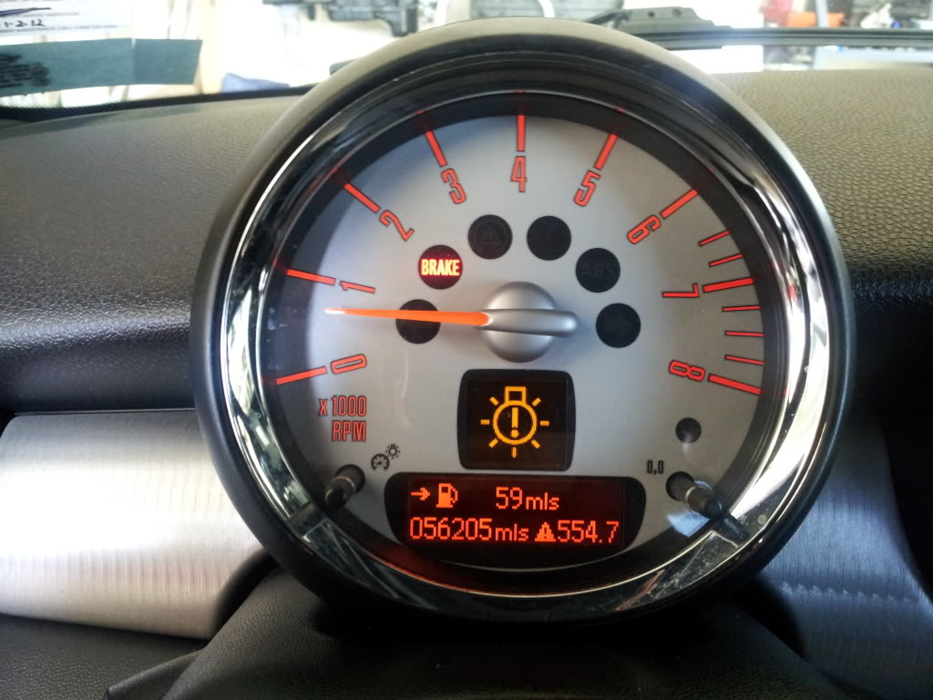

Does anyone know what this means?

One of your lights are out.

Ok thanks. I had minor fender bender. I just picked it up from the Auto Body repair shop and this is on.

How do I figure out which bulb? I checked and can't seem to find one out.

They can be difficult to find. I had a reverse light that worked off and on after being rear-ended. I would get this warning light intermittently. You might have to keep checking closely until you find it. The license plate bulbs are also difficult to see.
One last thought would be did the body shop use the correct bulb? That might give you a warning also.

NO!, it means your parking brake is on!

Now it couldn't be too hard to figure out which bulb would be out, but like the other poster says, looks like you're emergency brake is on.

Refer to these instructions to narrow down which light is triggering the Check Control Message (indicated by the little triangle):
https://www.northamericanmotoring.co...-messages.html
