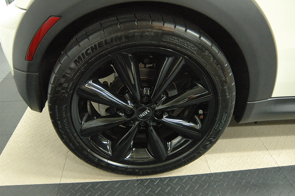

Not sure of the factory code for the wheels but they came with 205 mm Bridgestone rf's so I upped the width by 20 mm (meant two size widths, not one) with no problem with Michelin SS 225's.
Here's a pic with the rf's.
Michelin's
