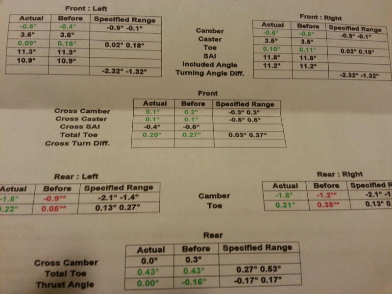

i had alignment done with two rear new tires replacement from firestone. And they took about like an hour for only rear alignment.
I just test drove on freeway..I almost had an accident because of f**king alignment. steering wheels are moving left to right left to right at 50-70mph.
please see attached and let me know if there is something wrong.

Alignment specs generally look pretty good to me.
Was the car wandering?

Looks like you have two different types of tires from your other thread. Also you may have run flats mixed with non run flats. This can be a bad combo.

This can be rather difficult to diagnose from afar without driving the car.
I used to have a car that tramlined a lot due to tires. Not sure if that is your issue here.

if the front end shakes at highway speeds have them balance the tires and check the front end for any worn/broken parts. If all else is good I'd say you have a bad tire. The alignment specs seem good. If the car pulls to the right, most likely a bad tire. If the steering wheel is crooked, most likely it was a little off center when they did the alignment

As I said in the other thread, BUY A SET of tires. You have 2 tires from one manufacturer, and 2 from another. I told you htey may not get alone with each other.
A long time ago, I put 2 snow tires on the back of my RX7 and 2 reg tires in from. I thought I was going to die in the first 30 seconds. I learned my lesson.
DON'T MIX tire manufacturers or really even different models form the same manufacturer.

i took my car to firestone again and they testdrove it and they noticed that something was wrong. After rotation, tire issue is cleared but not sure about alignment.

The numbers look reasonable. Could there be something they didn't tighten back down again after adjusting? Are the tire pressures even and in a sane range?

I agree with the posts that your alignment looks good, and that the front/rear tire mix is probably the main suspect. That plus the somewhat slippery release agent on the new tires that takes 100 to 200 miles to fully wear off.

It doesn't take anywhere near 100 miles... Complete hogwash. Otherwise race cars, and auto cross cars would crash right away... And what fun would that be?...lol
Now that they rotated the tires and the feeling when away when driving straight, it will show up sometime later when you aren't going straight.
You have mismatched tires. At some point it's going to haunt you...
