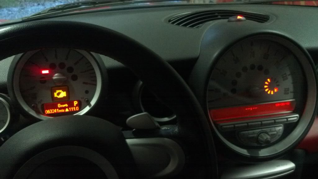

I've got an 07 R56 cooper S with the John works engine and this weekend I was on my way to an autocross event when I lost all of my boost. I could full throttle the car and I wouldnt get anything above 1lb on my gauge. About a minute or two after this the "check engine light" showed up on my Tach but does not come on the speedometer. I stopped at autozone to see if they could give me something I could start looking with, but nothing. They could not pull any code from the car at all. I checked that the boost gauge was still properly connected. I also checked all the tubes going to and from the turbo to make sure they were on good, and I also checked to make sure the noisemaker(aka waste gate, BOV, not really sure what to call it) wasnt stuck open. Heres the check engine light on the tach but not on the speedometer.

Can anyone help me with this? my Dealership is 2+ hours away and I dont want to risk driving it there.

As I said in my first post, I did take it to auto zone but there were no codes to be read. Its not lighting up the check engine light like it did when I had a misfire code a while back. The check engine symbol only comes up on the tach never lights up on the speedometer.

Your car is most likely in limp mode because of another problem that the ECU detected. This is just a guess by the way but from what I understand about the limp mode feature it is there to protect the engine from a self destruct situation such as damage caused from detonation "knocking" from poor fuel. I would think that there would be a code but it may not be seen with a simple OBDII code reader. I think the Bavarian technic tool would see the problem but if you don't have access you may need to check with a dealer.

I'm not running any tune on it just the factory ecu settings.
I'm going to go by the BMW dealership today to see if they have the Bavarian tool, and maybe get my car over there to be checked out
