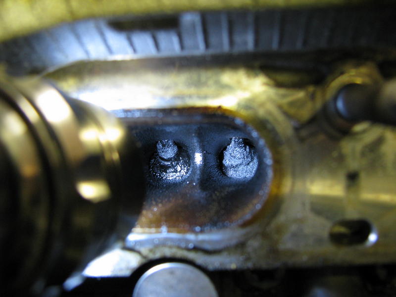

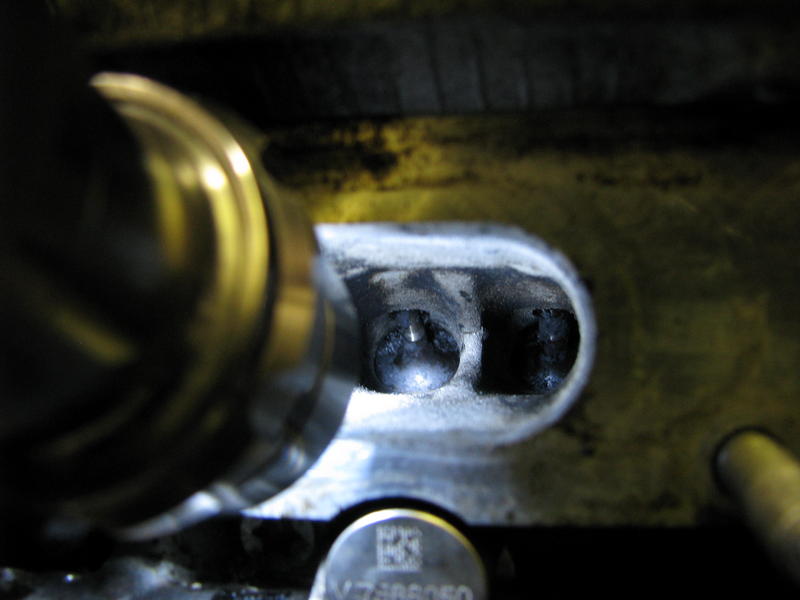

Thanks to this board, I tackled the suspected carbon build-up this weekend. I would like to give credit to whoever had the 13 page pdf in his thread, but I couldn't find the original thread. As you can see, Mine were very NASTY. It took about 8 hours total and I used Seafoam and Hoppes gun cleaning fluid along with a pistol cleaning brush and a pick (both bent about 45 degrees at the end). The difference is amazing, which does not surprise me considering the amount of crap in there. when I first took of the manifold, I couldn't even tell which valves were open and which were closed. I had to spray Seafoam in there and see which one didn't leak out. I ordered the BSH catch can and it will be installed next weekend. Thanks guys!

To follow-up, could you elaborate your driving habits, average drive time / mileage, and other possible attributing factors to your carbon build-up?
I'm wanting to see if there's a direct correlation to one's driving habits and the amount of build-up found.

we bought the car used in 2009 with 40K miles, so i assume they were mostly highway miles at that point. in the last 3 years we have put 20K miles on it and they have been mostly short trips around town. it is my wife's car and she drives, well, like a girl (no offense meant to any of you of the fairer sex). FWIW, i have done the Seafoam in the intake every 6 months for the last 3 years. Either it does no good, or the valves were to dirty when we got the car.

I've set a groupbuy for the SoCal peeps and have been stressing the importance to having this kind of procedure done to these director injection based cars so this is a prime example of how they'd look unaddressed.
I'm glad you tackled this via DIY and commend you again for the before and after. Every MINI over 40k miles really should consider getting this done whether at a shop or by themselves....
