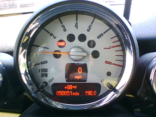

I bought my MINI in July 2008 and I am very happy with the service and performance it has provided. I passed the 50k mile mark on my way to work on Friday and thought I'd post my service experiences.
Here is the list of repairs I've had performed on my MINI:
Date Miles Repairs
8/13/2008 800.0 Replaced Airbag Control Unit - This was the most disappointing MINI related problem since purchasing the car. I owned it less than a month and had only put 800 miles on car. No one had part in stock and it had to be shipped from Germany. The MINI sat at the dealer for two weeks until repair was completed.
7/07/2009 10,663 Reinitialized windows after driver's window goes down after being put up.
7/07/2009 10,663 Replaced timing chain tensioner due to rattling noise.
7/07/2009 10,663 Replaced tailpipe tips due to recall.
5/05/2010 17,660 Adjusted sunroof due to excessive noise.
5/05/2010 17,660 Replaced passenger side door actuator due to unable to open from inside.
7/5/2011 35,676 Replace master cylinder as brake pedal would slowly creep down to floor with constant pressure on pedal.
4/4/2012 46,188 Replace auxiliary water pump due to recall.
4/4/2012 46,200 Returned car to dealer due to overheating after auxiliary water pump replacement. Coolant bottle was empty, filled, checked for leaks, found OK.
6/21/2012 49,557 Free vehicle inspection offered by dealer prior to expiring warranty, found nothing wrong but I appreciate their offer.
Well, the list is longer than I expected. All the repairs listed above were free as they were covered by the warranty. I live about an hour from the dealer, so I tried to have as many repairs done in one trip as possible. I did not include any regular service items or state inspections, but everything has been done at the dealer except unscheduled oil changes, brakes, and mods. Otto's Mini in Exton PA has been great to work with and provided me with a free loaner whenever needed.
My biggest disappointment while owning the car was being rear ended in April 2010. The car was repaired and you'd never know it was in an accident.
My MINI experience has been great and expect another 50k miles and, hopefully, with just as much fun!
