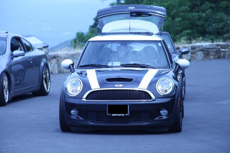

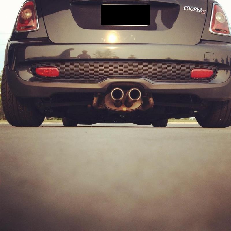

Just installed my vmaxx, and drove em pretty hard. They feel great! Only complaint is there is no adjustable dampening, but they are worth the cash if you dont mind the dampening issue.

How are the coilovers stiffness wise? looking into getting some for myself and just wanted to see how they are.

People complain that they are "too bouncy" The roads in my area are pretty smooth and I dont see an issue, Stiffness wise I would say they are a few steps stiffer than stock.
