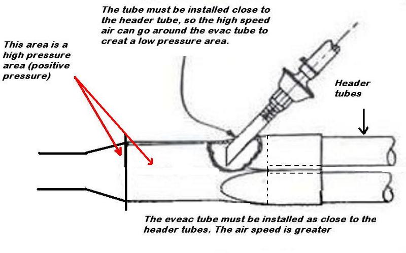

OP here, I made an adapter for the dipstick hole that I can monitor the actual crankcase pressure to the .01 psi. I tested it last year sometime but can't remember what the actual numbers were. I will retest with videos showing the results when I get a chance.
On the draft tube topic if one were to install draft tubes why not use the exhaust system to evacuate the crank case. Here is a link to a V8 system.
http://www.summitracing.com/parts/mi...FexDMgodahsADA
It must be welded into the exhaust pipe.

Here is an image I found on the net showing how it installs.
Attached Thumbnails PCV delete. Possible Isues resulting....-evacsysteminstallsy2.jpg
