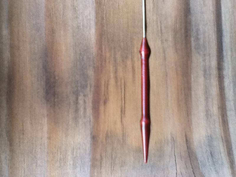

Ok, went and got a siphon, and pulled out oil...
Dipstick still showing way high...
see pics..:(
1st one clean OEM,
then w/oil all over it
3rd, Craven clean,
then dipped
then Siphon setup
then after siphon on craven.
Attached Thumbnails Oil Level and Dipstick-img_3698.jpg   Oil Level and Dipstick-img_3700.jpg   Oil Level and Dipstick-img_3701.jpg

Did you wait for a little while for your oil level to even out before dipping, after siphoning? At least twenty minutes or so? Hmmmm.

Bhavin - how much oil did you extract from the crank?
Who did the last oil change?
If the Craven is in fact reading correctly, the oil level on
the stick should not be higher than the upper bulge.
I can also see why you folks with the OEM (red ended stick) have
such a hard time reading it. My 07 isn't anywhere that hard to
read.

I didn't wait that long before checking after siphon. I will wait a while now to check again.
I extracted about an 1/8 of a gallon according to the jug i used. = approx 1/2 quart.
BMW did the last change. Since then, its been in for a few things, and most recently the tech told me that these cars burn a quart every 1k or so..i should be checking it at least 1x month...and adding.
well since my last check up...where they added to make it full. I have added 1.5 quarts at different times... been driving it .. expecting it burn off as usual.
got my craven dp in, and here i am.

the difference in oil reading between craven and oem dipstick is disconcerting. how can people get 'overfill' reading on the craven and not on the oem? i plan on buying the craven but would rather trust oem even if it takes me 5 minutes to read it.

well. i took it to a local shop and they did a oil change for me.. first i had them siphon until i got a good reading..and they pulled alot out..i was probably 1.5/2 quarts over..holy cow!
well i am now back to normal, and can get good readings with my new and the oem dipstick.

Twas me who added any oil ...I added as I thought, it was burning as usual(without being able to get accurate reading of OEM dipstick) ...well mine burns not nearly fast as I initially suspected...with new Craven DipStick I can keep a quick eye on it regularly.
I noticed my mpg decrease during the period I was driving with extra oil...
Im really glad I took action on it though.
