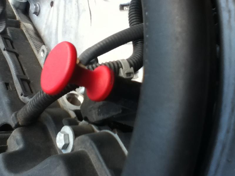

Here's my new Craven dip stick inserted into the dip stick tube. At this point, it stops and has to be taken out with the aid of pliers. You can see what the pliers have done to the red ****.
Surely this can't be right. Notice how the **** does not bottom out against the black tube. How will I know if the dip stick is inserted to the proper depth to get an accurate reading?

That can't be right. What year is your car?
I'd take it out and go back to the stock one until
you figure out what's going on.
The first one they sent me goes in a little further than yours, but the second one they sent me was even worse than your pic. Send a note through the Cravenspeed website so that they know it's not just me!

drsimmons & Muzak:
Actually, I did send the same pictures to Kellen at Craven, as he requested. And yes, I did put the stock dip stick back into the car. My car is a Cooper 2010.
