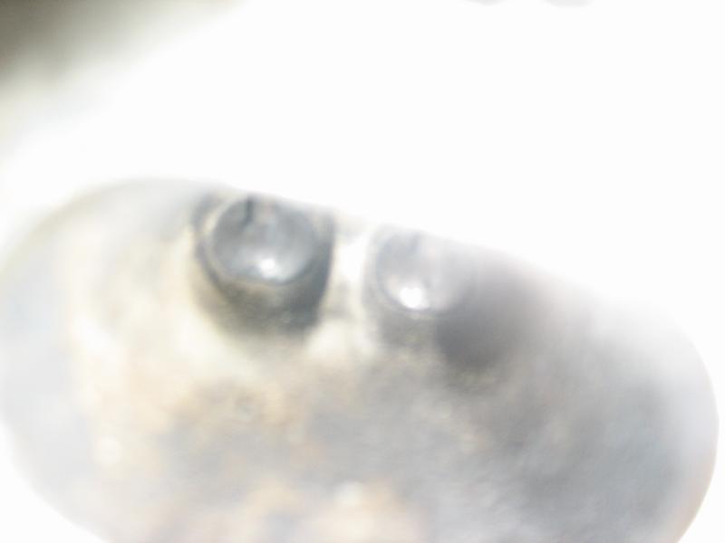

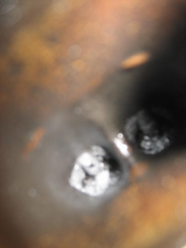

Hey Gang,
I just pulled the intake on my 2007 MCS with ~46200 miles.
Attached are blury pics of what I found. What is evident is that I cannot see how this poor engine was breathing at all!!
Tommorow I plan-on soaking the intakes in with carb cleaner and scrapping clean (as much as possible).
My question is: With so much crap on the valves, it is difficult to see which valves are open/closed.
Is there another way (other than visual) to tell when the intakes are closed on a particular cylinder?

Finally finished the intake valve cleaning...
Hey Gang,
Just finished the intake valve cleaning on my 2007 MCS.
It was approx:
-3 hours to remove the intake manifold
-10.5 hours to clean the valves
-1 hour to install the intake manifold and test
As the 'before' pics (above) will atest, the valves/intake of the head were pretty caked-up with gooey carbon. In the 2nd and 3rd cylinder intakes, it was difficult to tell where the valve ended and the carbon build-up (from the rear of the intake passage) started!! Really nasty.
But, the work was worth the effort. Now when I am accelerating hard in corners, the steering wheel (once again) suffers from extreme torque-steer (me likes! ) and the acceleration is definetly more 'head-snapping'.

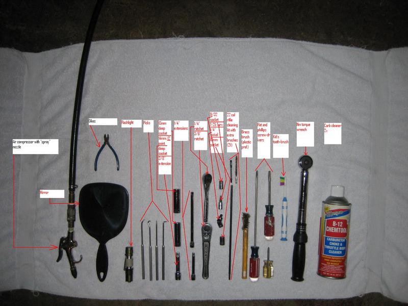

Tools that I used....
Hey Greg,
Below are the tools that I used. Hope it helps!
Attached Thumbnails More intake carbon input...-tools-for-intake-valve-cleaning.jpg

Thanks Surfin for the picture. The labels for the tools are terrific. Thanks again.
Glad your results were great!
