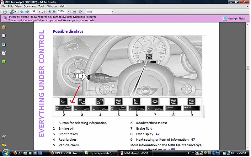

When you look up your service info on your OBC, you should see each of the displays seen on the attached picture. As you can see, the oil one shows miles to go and a due date (red arrow). I just don't know what drives that date...

My apologies, I did not know that there was a date and a mileage indicator in the service info. I stand corrected, thanks. I'll need to check this on my Clubman tonight!
As you asked, what happens if you get to the date, but not the mileage countdown? Does the dashboard indicate service is needed, or does it still just say "xxx miles to go" when you turn on the ignition?

No problem... Yep, I reached the due date but not the mileage and the "service needed" indicator popped up. It said "check oil" so that's what I did, I thought the oil level was low. It was good to go and I was just going to disregard it because I still had 8000 miles to go but I happened to take my car in for a strut change and they caught it and told me I needed an oil change because of the due date. So moral of the story, keep an eye out for service due dates as well as mileage due dates ....
