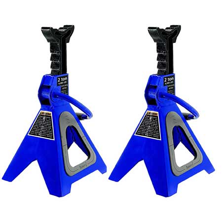

I don't like them much. The base on those looks a little small to me. You want as wide a base as possible for stability. They have pins for holding them up when they're extended - not very convenient to use, quite fiddly.
I like this type better:
The legs are heavily braced and widely spaced - very important so they won't collapse.
They have a ratcheting arrangement at the top, too - this makes it really easy to extend and retract them as you use them, much better than the pins.
The ones in my picture are about $30 here in Canada for a pair. Good deal!
And please PLEASE do NOT buy or use those cheap stamped steel kind you see in Walmart or hardware stores - they are round, tube-shaped and have no bracing between the legs, are very lightweight and cheap. DANGER!!! Spend some extra money on something safe, don't try to "cheap out" here.
Get the heaviest-rated ones that will fit under whatever car you will use them with. I'd say 2 or 3 tons rating minimum. Overkill is good in this case!

Those look very nicely made and stable. Rubber pad on top saves scratches and paint damage to underside areas - a good thing. The ones in my post above have a hollowed out notch-type arrangement on top - also useful at times, as when the jackstand is placed under a suspension arm or something like that, the notch cradles the part and prevents any movement. I have a hunk of rubber about 1/4 inch thick that I can put between the jack and the car underside, if necessary.
Both types are good. The most important things to look for are the quality of construction and the nice wide reinforced base.
And, just remember, a vehicle CAN slide and fall off of jackstands too, not just a jack. Don't ever think you're totally invincible just because your car is on stands, even good ones. I hate to sound like your parents , but you can be seriously injured or worse if you aren't extremely careful when using these things. I have some personal experience with this subject, so I am a bit preachy - - but justified, I think.
OK, lecture's over!
