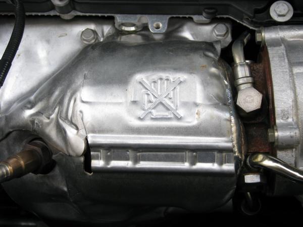

Just thought I would pass on a little info on my resolution for melting factory scoop and high hood temperatures ....
First change was the addition of the WMW turbo wrap. My main goal was to control the rapid temperature changes in the turbo turbine housing and keep it more constant which not only helps temperature issues but in spooling (you can search google for more info on this). Rather a pain to install, but I feel it is worth the effort. End result, very effective and my goal was reached.
HINT: before re-installing the factory heat shield, cut notches into the front the shield so instead of having bolt holes, you have slots going to the holes. This makes it very easy to put the front bolts back on, then slide the shield over it and then tighten back down. Works like a charm and no headaches trying to get those front bolts back on.
Second change was the addition of the M7 newly redesigned heat shield. This was added to effectively control under the hood temperatures that the factory worthless beer can metal heat shield can not. This proved to be very effective and also looked very OEM. To boot, it only took a couple minutes to the install with no blood left behind. End result, a very cool hood !!

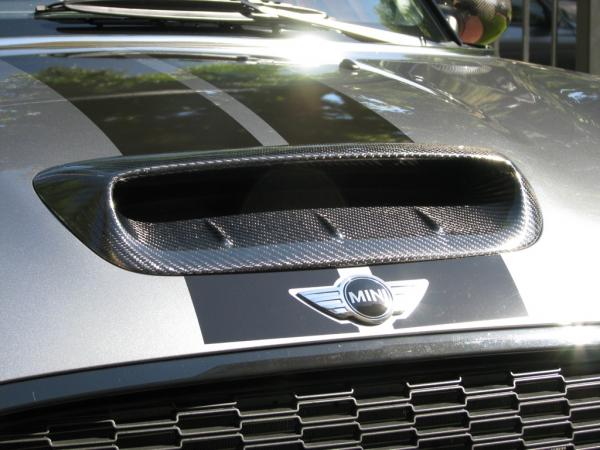

Third change was the addition of the M7 Vortex CF scoop. Since my factory scoop was damaged and honestly a worthless fake scoop, I replaced it with a very functional and slick looking carbon scoop that will only melt if the car catches fire ! The scoop serves two purposes, feed fresh air to my CAI, and provide a curtain of cool air between the hood and engine. End result, also very effective on two fronts, cool air to the CAI and cooler hood.
So with a engine temp of 221F and the exhaust gas temp of 1450F, the hood is only slightly warm (still need to get my own IR temp probe). Leaving the car parked in the sun, the hood gets hotter that way than the engine running.
Anyone doing this setup will be very pleased with their efforts and so will the car !
Many thanks to WMW for making a wrap to fit that small hair drier turbo and to M7 for such an easy bolt on solution that really works, slick looking functional scoop, and the wonderful CAI

WMW wrap installed ....

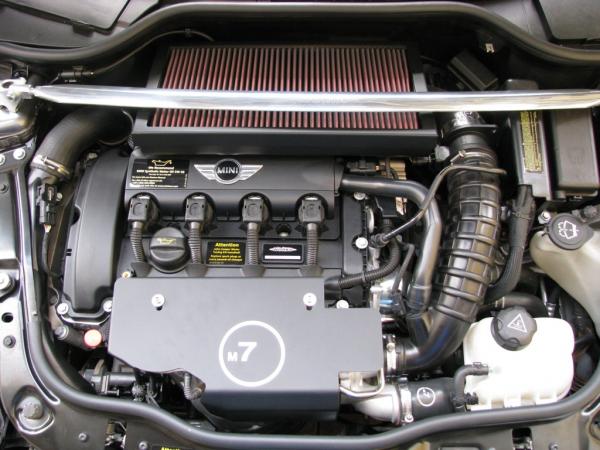

M7 heat shield and Super-AGS CAI installed ....
M7 Vortex scoop in CF installed ....

i like your intake, where can i read more about it?

Love your setup, morbius. I ordered the WMW turbo wrap before I even picked up the car and I've got the CF Vortex on order.
Maximus, go to http://www.m7tuning.com/parts/produc...roducts_id=122 to read up on the intake. I've been thinking of getting that one myself. Kinda pricey but very nice.

is the scoop really going to accomplish anything? i noticed on the other side of the hood, directly under the scoop, is a black padding material presumably for heat absorption. i didn't look too closely but looks like its closed up on the back end. are you required to remove this material to install the CF scoop?
CF on yellow does look good. should go well with black stripes but the wife will need some convincing...

as far as temps go, the scoop just withstands heat better cf has a very high melting point....which is why i think if ur going to spend 200 on a wrap and still possibly melt your scoop (long hours under the sun might melt ur scoop too), might as well spend 300/400 on a cf scoop....
that is of course if scoop melting is your concern
if its just hood temps in general, then this guy has a clear solution.
sorry im not trying to change this into a scoop melting thread just thought id add that in there

Yes it does. As the air moves through the scoop and into the engine bay, it will help move more of the air above the turbo via air currents. You can experiment with this with the existing factory. Remove the stock one, remove the screws on the back side of the scoop that holds on the grill and remove it and reinstall. Now you have a functional scoop with a smaller profile but still able to move air through the engine bay. Just doing that drops the temp slightly which is better than nothing at all.
No the black padding does not have to come off. The M7 scoops are a direct replacement with the exception of an additional hold down bolt which the stock one does not have.
i thought the padding effectively block any air coming in from the scoop, is that not the case? sure looks that way.

I do not have pics handy on how its done. But the black padding sits directly under the scoop. In that area, there is 2 layers of sheet metal and the scoop sits between them. If you look and feel further back you seel a slot opening that happens to line up the existing scoop fake vent. If you remove your stock scoop, you will see what I am talking about. The padding happens to sit right above the turbo heat shield ...
Hope that helps.
