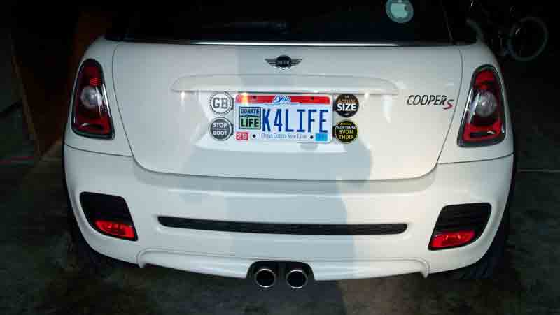

Hi all!
After some time now I have had a chance to get the fog light switch activated. After doing the install myself....link: http://homepage.mac.com/mcg_rebar/Th...ust/30/30.html ...I had to await some time off from work to actually make it to the dealership.
The activation took about 2 days as the technician did the job. Some tinkering with the verification of my work was done, all of which checked out. The reprogramming did take a call to someone else higher up, whom helped them out a lot. While they were at it, I had some repairs done from my installation (damage to the plastic and such). The interior looks some better (save one issue). Here is the page that details the final outcome (including a video) http://homepage.mac.com/mcg_rebar/Th...ber/01/01.html. I also included a scan of the paperwork from the dealership for further proof that it can be done.
The car, a 2009 MCS is now more of what I wanted several months ago when I came across this page. Two more years from now will get my next Mini, this time with the rear fog lights.
My advice...do the fog lights. Do the Gimme-A-Brake kit. Do the work or get it done; it can save you from being hit from the rear.
M. Rebar
