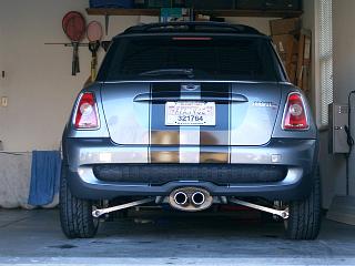

tjtull's Avatar
tjtull
Joined: Jan 2008
Posts: 871
From: St. Louis, MO
Originally Posted by jw34
I'm thinking about the extra brake kit for my MC. Luckily I only have to pry off one light trim. Good tip on where to pry. What did you use as a tool for this?
I used a small-tipped flat head screwdriver with duct tape wrapped around the tip. I was very careful when prying it off, so as not to break the trim or mar the paint on the body. I went around the edge of the trim piece in several different places and it came right off. No damage to the trim or the paint.
And I second DrewN's comments; GREAT MOD! The lights really completed the rear bumper of the car.
Here are some before/after shots. Sorry if you can't see the actual illumination of the lights, it was too bright in the garage to pick it up.
Attached Thumbnails Rear Fog Lights - Option Question-mcs_garage_rearbottomview.jpg   Rear Fog Lights - Option Question-mcs_brakelightkit.jpg
