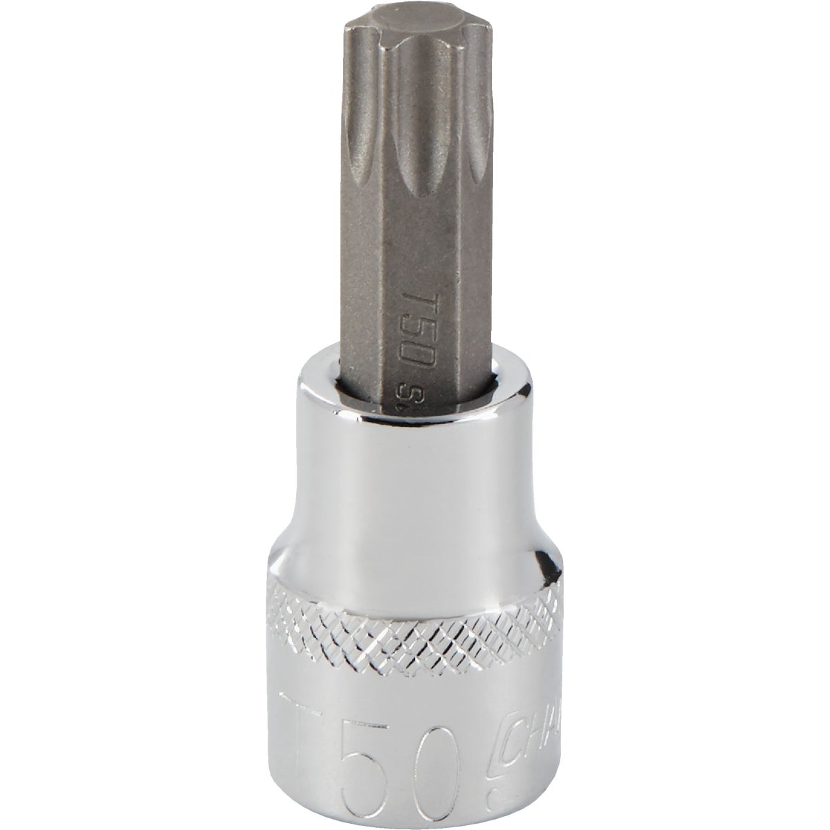

- 8mm allen key or socket (if a socket, you will need a ratchet): oil drain plug
- 8mm hex wrench or socket (if a socket, you will need a ratchet): coolant reservoir
- 27mm hex socket and 12in extention: oil filter housing
- rags
- oil drain pan
Mine takes a T50 torx not an 8mm allen.

Hello,
My Cooper also uses the T50 torx for the drain plug. Also, 27 mm = 1-1/16" socket. I use a six point socket to support the hex surfaces on the oil filter cap. A torque wrench to tighten the cap.... 25Nm ( marked on cap ) or approx. 19 ft/lb.
Oil filter should come with new o-ring and drain plug cooper crush gasket.
That is what I use as well, but I believe an allen also works. The torx might be less likely to round out the plug socket if the dealer over torqued it.

What is the correct torque specification for the drain plug?
MiniMania says 30 Nm or 22 lb-ft. See this link:
http://new.minimania.com/web/Item/G2.../InvDetail.cfm
But the pdf document I found at the following thread says 25 Nm.
https://www.northamericanmotoring.co...d.php?t=117695
Which torque specification have you guys been using?
Old Dec 18, 2007 | 06:51 PM
Robin Casady's Avatar
Robin Casady
Posts: 7,578
From: Paradise
That PDF has 25 Nm for both the drain plug and the oil filter housing.
I've used MiniMania numbers: torque the oil pan drain plug to 22.0 lbs/ft and the oil filter cap to 18.5 lbs/ft.
