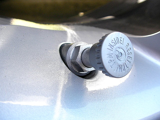

Anyone who is just getting their new MC with runflats and is thinking of buying new wheels and tires, check to see if you have the new tire sensors mounted individually in each wheel. My new MCS came with them. I preordered my mags and non-runflats from a tire dealer before I got my car. Came time after my MCS arrived, I went to have them installed, and the tire shop said they can't install them. They needed the four special sensors. Since it was a "no choice" deal, I said get them. Waited three days, just called them now to see if they came in, he said it is now backordered from Mini.
They make it a law to have these sensors, they make them expensive ($235 for a set), and they are low in stock.
I feel so much less secure in the knowledge that I have no spare. I have tires, wheels and rims that are special order and hard to find, and sensors that are mandatory, but very unavailable and very expensive. I cannot use a fix-a-flat type material in a pinch, because it will probably ruin my sensor, which will cost $60 and will probably be backordered.
I have always checked my own tire pressures religiously for decades. Now I have to pay mega-dollars for a high-tech system that does it for me, but....it does not, in "ANY" way, help me in a jam with a flat, in the middle of a long trip.
Why do I feel so much, less safe, for so much more $$$$$$ ?
Have I gone "back" to the "future"?

When was your MC built? This is the first I've heard of MINI going to wheel sensors. Up to now it has been determined by wheel rotation speeds.

After the fact, I did look at the other new Minis on their lot, and I did see more of the new sensors installed. They definitly look different. All metal valve stem with a valve stem cap, which is grey plastic and bigger. It says on it "TPM INSIDE" - "RESET TPM"

Originally Posted by alicecooper
My car just came in last wed. I talk about it more in this thread, towards the bottom.
https://www.northamericanmotoring.co...d.php?t=112068
Post a picture please.

Here it is. The valve stem cap is the size of a dime.
Why not showing? I ran a test in test section. The picture is in the test sect.

Thanks for posting the picture
Wonder if these sensors can be swapped over to aftermarket wheels

Yes they can.
The tire dealer gave me that option, but I'd rather have a complete working extra set of wheels, just in case.
I'm going to use the new mags and non-runflats for summer, and the OEM wheels with RF's for winter.

Do you still have a button to reset the TPMS or does it reset automatically once the low pressure condition is cleared as in the Subaru?
