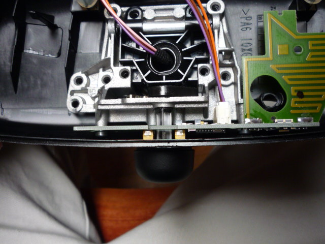

Originally Posted by cjmadura
Remove the chip from the mirror housing by carefully unscrewing the cross-heads.
I've got this far...I can't see how to unscrew the "cross-heads" (what is a "cross head"?) to get the chip out of the mirror, as the screws holding it in are sandwiched in there...no way to get a screwdriver on those screws...see attached pics...the screws are those tiny silver "buttons" between the mirror housing and the circuit board.
By the way, I'm taking lots of pics of this operation...one thing I noticed is that there are NINE clips holding the two halves of the mirror case.

RE: Check my pic of the chip inside the mirror. I can't figure out how to unscrew the chip?
Here's the fun part. to unscrew the chip, you need to remove (i.e. break) the **** which controls the day/night mechanism. Either that or drill two holes carefully through the housing directly over the screw heads. Make sure the drilled hole is large enough to fit a screwdriver thru.
I pried off the ****, unscrewed the chip from the housing, then removed the two awkward screws. I didn't want to damage the housing. I reassembled the now chip-less mirror, and bought some JB Weld 2-part epoxy from Home Depot. I mixed the epoxy, pressed a fair amount into the hollowed ****, and pressed it back onto the stalk nice and straight. 24 hours later, that sucker is one piece again. Now I can put the mirror back into tha car anytime and no one is the wiser! The chip now resides above the interior light assembly in the headliner and works perfectly. Just make sure to secure the chip so it doesn't rattle around. I used a 90 degree piece of heavy plastic as a bracket.

I posted pics of my successful removal of the OEM mirror and installation of replacement mirror here:
