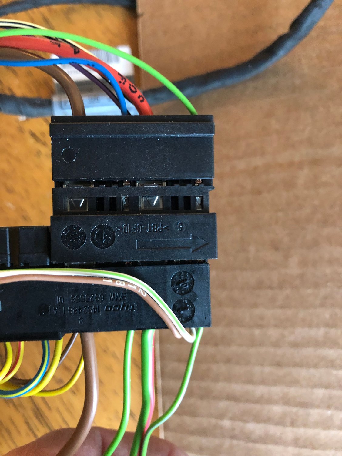

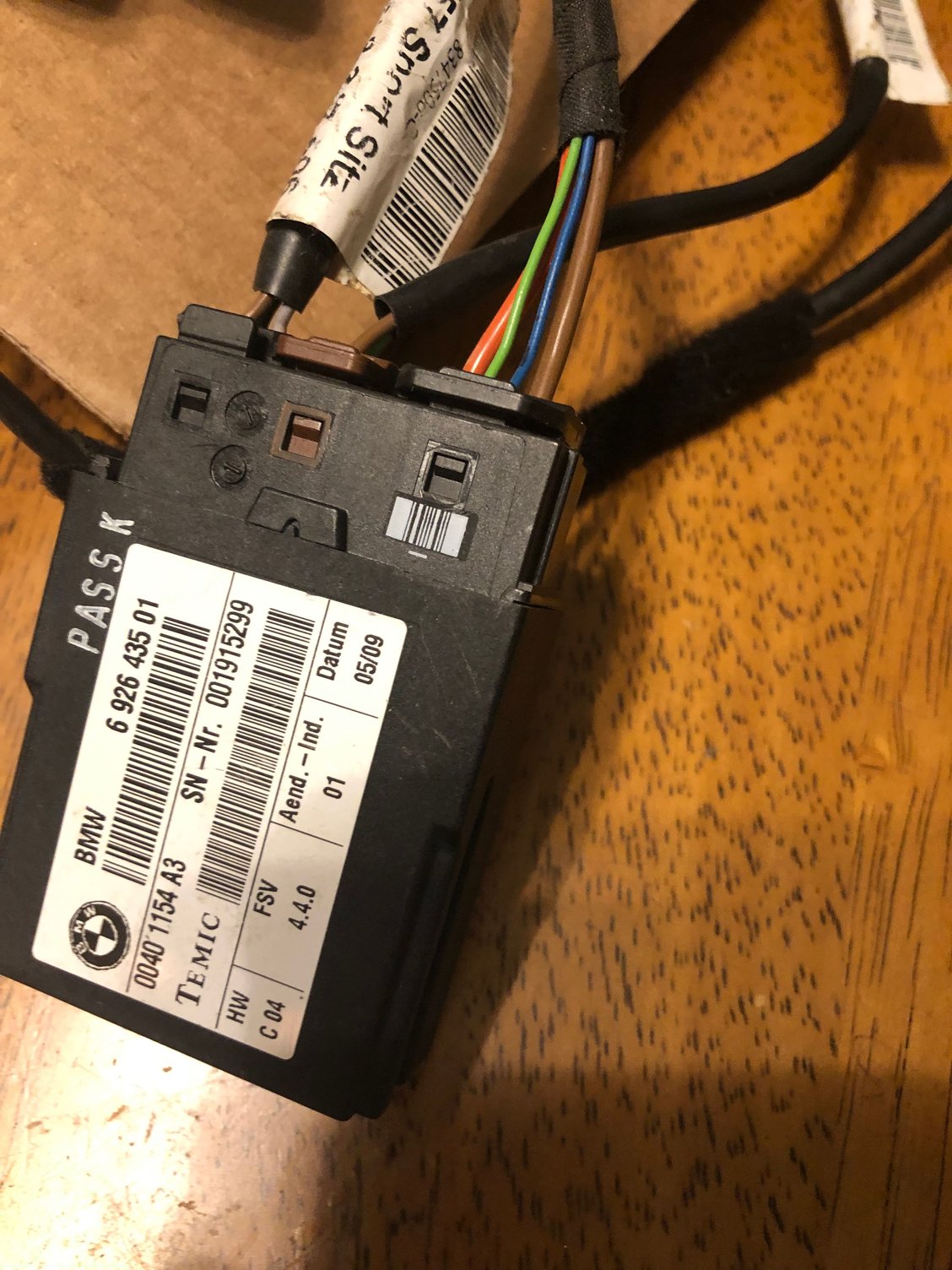

Have some Clubman seats I am trying to adapt to my Triumph TR6 (Have a 2006 S too). I have the wiring diagrams and read through various forums. Here's my problem.
I have the back and seat heater leads plugged into the module but I have 4 wires out of the module and the schematics show 3 wires including the brown ground wire. I've seen pictures of modules in posts with the same 4 wires out to the controls like I do but have found no mention of the two lighter gauge wires. Which one of these goes to the combo seat heat/mirror panel? Have the small gauge blue and green out of the module which transpose at the main harness connector to what seems like green/white and green with maybe violet. My connector pigtails I have do have the white/violet sense wire to the control panel.
Can someone tell me which wire from my module should go to the white/violet sense wire at the control panel?
