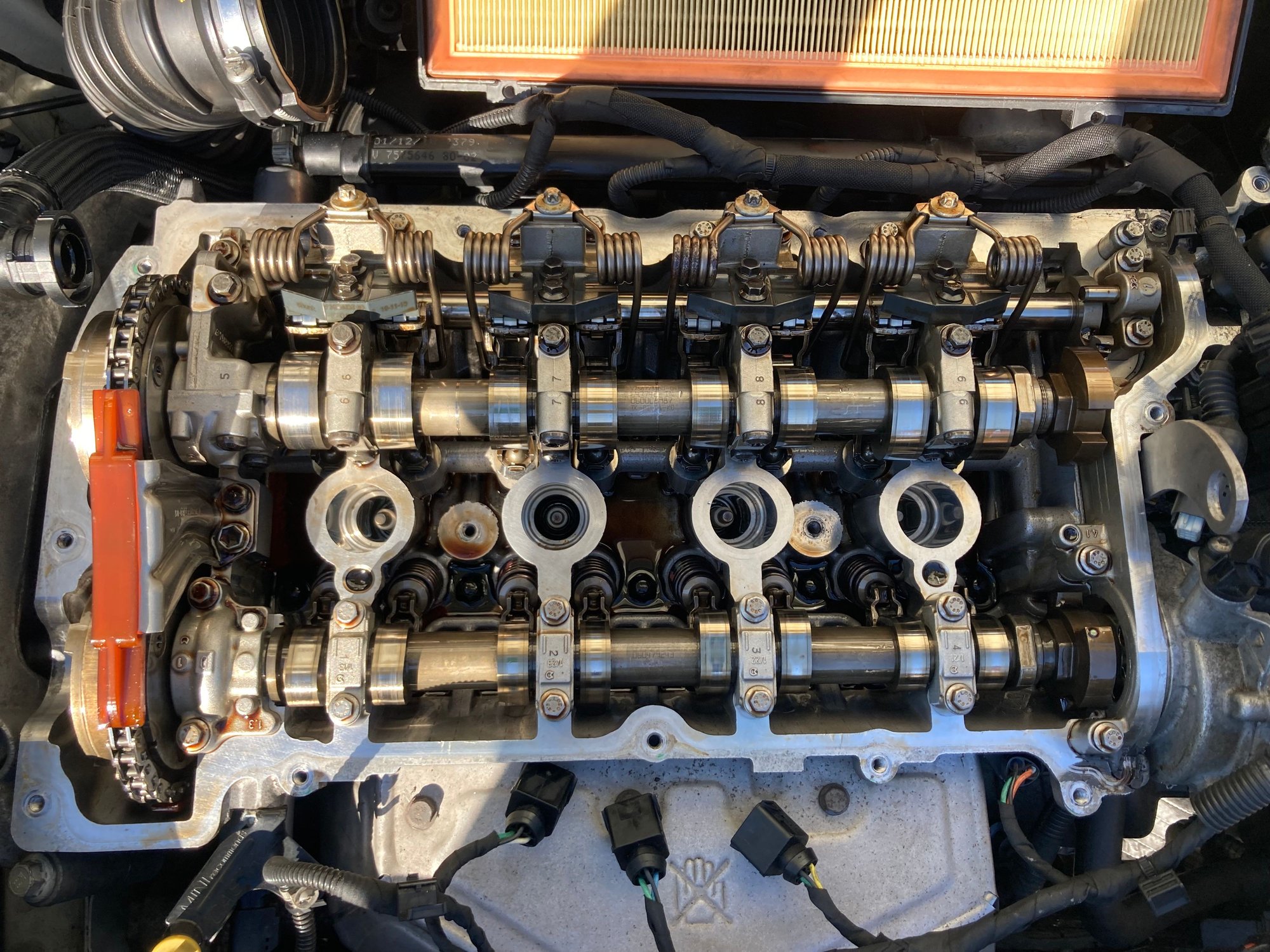

Hello everyone, I finally figured out what is the problem...
Removing the valve cover revealed that the third cylinder rocker arm and spring had come loose. Luckily there was no damage. We put it back and we thought we solved the problem. For checking the timing, I didn't pay much attention just made sure the the writing were up when the pin is locked in the flywheel. It was still misfiring.
Today I removed the valve cover again and checked the timing again, and indeed it is completely off. Bentley manual says that the exhaust lobe on the cylinder `1 should pint in a lower inward direction and the intake side upward inward direction. On my engine it is completely off. So the mechanic who rebuilt the engine completely messed up the timing.
I am attaching the photo. Could you please confirm if the timing is off?
I am looking at the Bentley manual for adjusting the timing and it mentions after locking the camshaft with the special tool (which now I have), you need to remove the timing chain tensioner and put the dummy tool. I want to know if I need to remove the throttle body to access this tensioner bolt or can do without it? I saw some videos where they showed the throttle body is in the way and it is very difficult to remove one of the bolts. But that video was for n12 and mine is N16.
If I do not have to remove the throttle body, I should be able to follow the bentley instructions which says I have to put the locking tools, loosen the bolt on vanos sprockets and then torque the vanos bolt. (I am still not clear how this process will put the lobes on the camshaft to the correct position).

I am quite confused which directions the lobes should go. The instructions and photo in the bentley manual don't make sense. I think on my camshaft it is impossible to have the numbers on the top and the lobes pointing to directions shown in Bentley manual. Can someone confirm? My engine is N16.

I figured out that the instructions in Bentley are wrong. Wrong photo, wrong and incomplete instructions. I am quite disappointed from the Bentley manual although I have used some good repair manuals by them in the past.
i did the timing adjustment by locking the flywheel, loosening the camshaft sprockets, locking them camshafts with the timing tool, removing the timing chain tensioner. Installing the dummmy tool and torquing to the spec, and then tightening the camshaft sprocket bolts..
