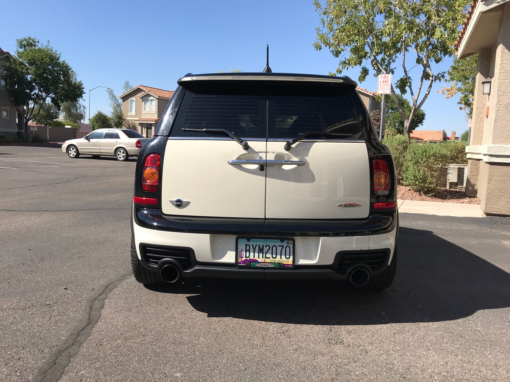

I've checked the bulb, bulb holder and connector and have determined that there's no power in the connector. Everything appears intact as far as I can see up into the body so my question is where do the wires run for this side of the car? I'm guessing they're probably under the rocker panel but before I go tearing into it, I need to know for sure.
Has anyone else experienced this problem in a Clubman? I know it's happened in hatchbacks but can't find any instances for Clubmans

Drivers side doesn’t have a backup (unless you are in the UK). It only has one backup bulb on the right side.

Wow, and to think I never bothered to look at the lenses! My neighbor alerted me to the missing backup light and I immediately went to pulling the bulb without even considering it was as it is supposed to be! I wonder what it would take to enable the driver's side bulb to light? I would imagine UK lens are available.

On the drivers side, the bulb at that position is the rear fog light. Rear fog is an extra cost option in the US (standard in Europe, where it is required). If your car wasn't ordered from the factory with the rear fog option, it doesn't have a switch for it and the bulb will never light up. If you install a UK taillight and want the backup to light up, you'll have to run an extra backup wire from the wiring harness or from the other taillight.
