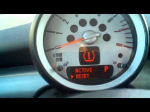

Old Mar 7, 2017 | 02:55 PM
MothAudio's Avatar
MothAudio
Joined: Apr 2014
Posts: 91
Old Mar 7, 2017 | 03:09 PM
MiniToBe's Avatar
MiniToBe
Joined: Jan 2015
Posts: 4,339
Likes: 437
From: Philadelphia PA
Yes the first picture is your flat tire indication.
the second is for the transmission error. It could be simple thing.
The third is for the outside temp indication that it js freezing outside.
Old Mar 7, 2017 | 05:06 PM
MothAudio's Avatar
MothAudio
Joined: Apr 2014
Posts: 91
Yeah, I know what the symbols represent. Not sure why they're coming on.
