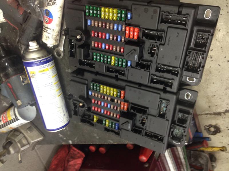

I attached a picture of the body control module that I replaced. That's the actual picture I took. Left one is the old one and the right one is the new one from the dealer. By the way, my Mini Cooper is 2009 clubman base model, not "S" the link to realoem took me to one for R53...
