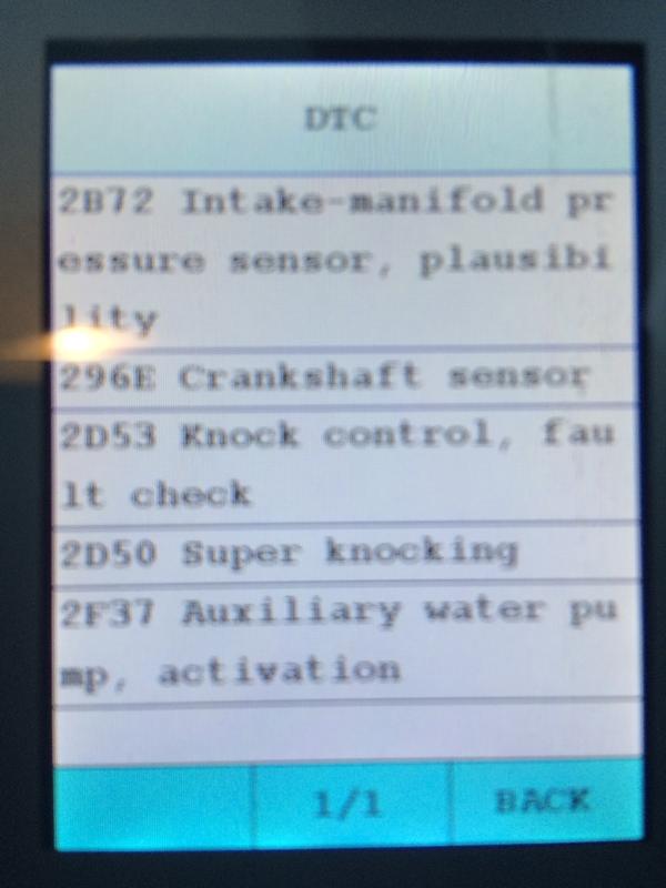

hi i have a clubman 2008 cooper s, right just driven home,and the car started driving like a pig, kept cutting out,i change all the coil packs,still the same,the engine light came on, limp mode,but still coundent drive it,had to be towed home,now ive put my fault code finder on her and this has come up,(pic inclosed ) so i reset the errors codes, and now its running fine !! i think, not been out yet but its ticking over ok,and not stalled yet ! can anyone please help !! or have had the same troubles

how many miles ? If about 75K miles you have carbon build up.

what guy ? But knock is most likely build up of carbon on your pistons and increasing the compression ratio and causing knock etc.
Unless you got some bad gas ?
