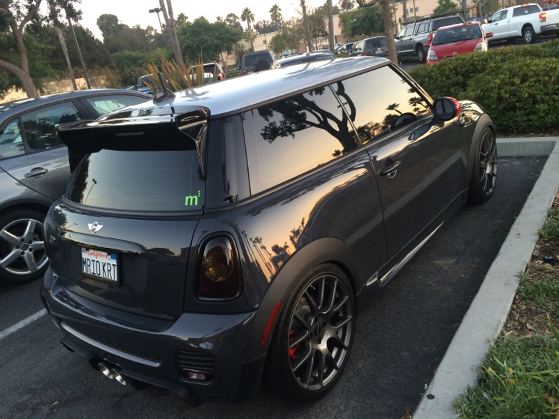

Lots of people do. I run 5mm because if I don't the coils will hit the 18" wheels.
Make sure they are hub centric and have the extra lip. I used Motor Tech. I think 11mm is the least you can go to create the bore lip and of course get the matching bolts
