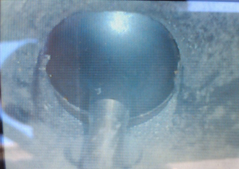

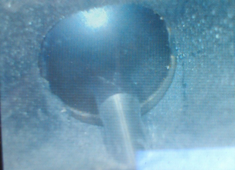

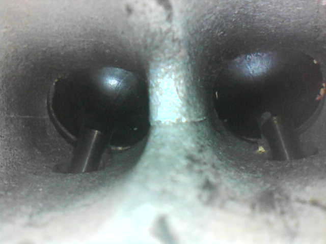

Just finished cleaning the valves & installing new plugs on my '08 S Clubby w/ 44,000 miles. I had a misfire code set last spring, cleared it and made it through the summer. Now that's it's cooling off, the car was running rough in the morning again, stumbling & set another misfire code.
Bought the BMW wand/vacuum adapter and went at with help from the various guides I found here. Took a few hours, mostly because I had one valve that I just could not get a big chunk of carbon out of. I think I spent more time on that one than all the others combined.
I bought the cheap inspection camera from Harbor Freight for this. It said on the box that it takes .jpg images, but it doesn't. So, I've got a few spectacularly crappy cell phone photos of the screen.
Here's a few of the before:
Attached Thumbnails Cleaned my valves-imag2355.jpg   Cleaned my valves-imag2356.jpg   Cleaned my valves-imag2358.jpg

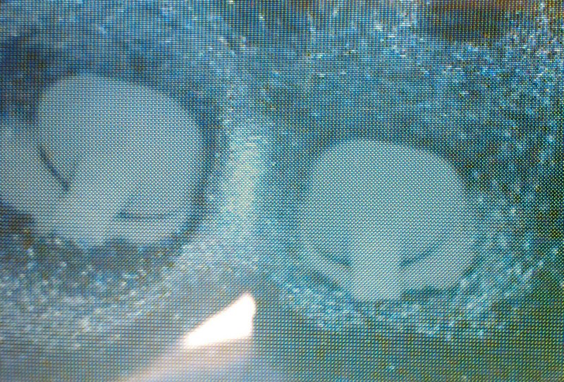

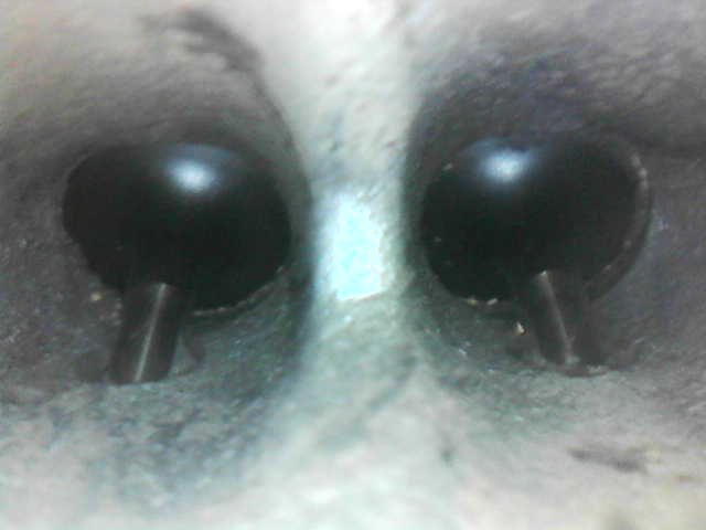

And a few after:
Attached Thumbnails Cleaned my valves-imag2365.jpg   Cleaned my valves-imag2367.jpg   Cleaned my valves-imag2368.jpg

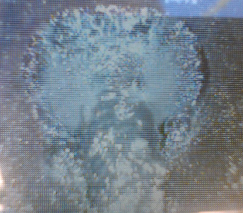

This is the one that gave me so much trouble. I just could not get that chunk of carbon out with the walnut media blaster. I ended up using a long, dental pick type tool. I could stick it down the intake with the camera in there and picked the chunk out. It actually came out pretty easily in one big, gooey piece. After that, another blast with the media and it looked good.

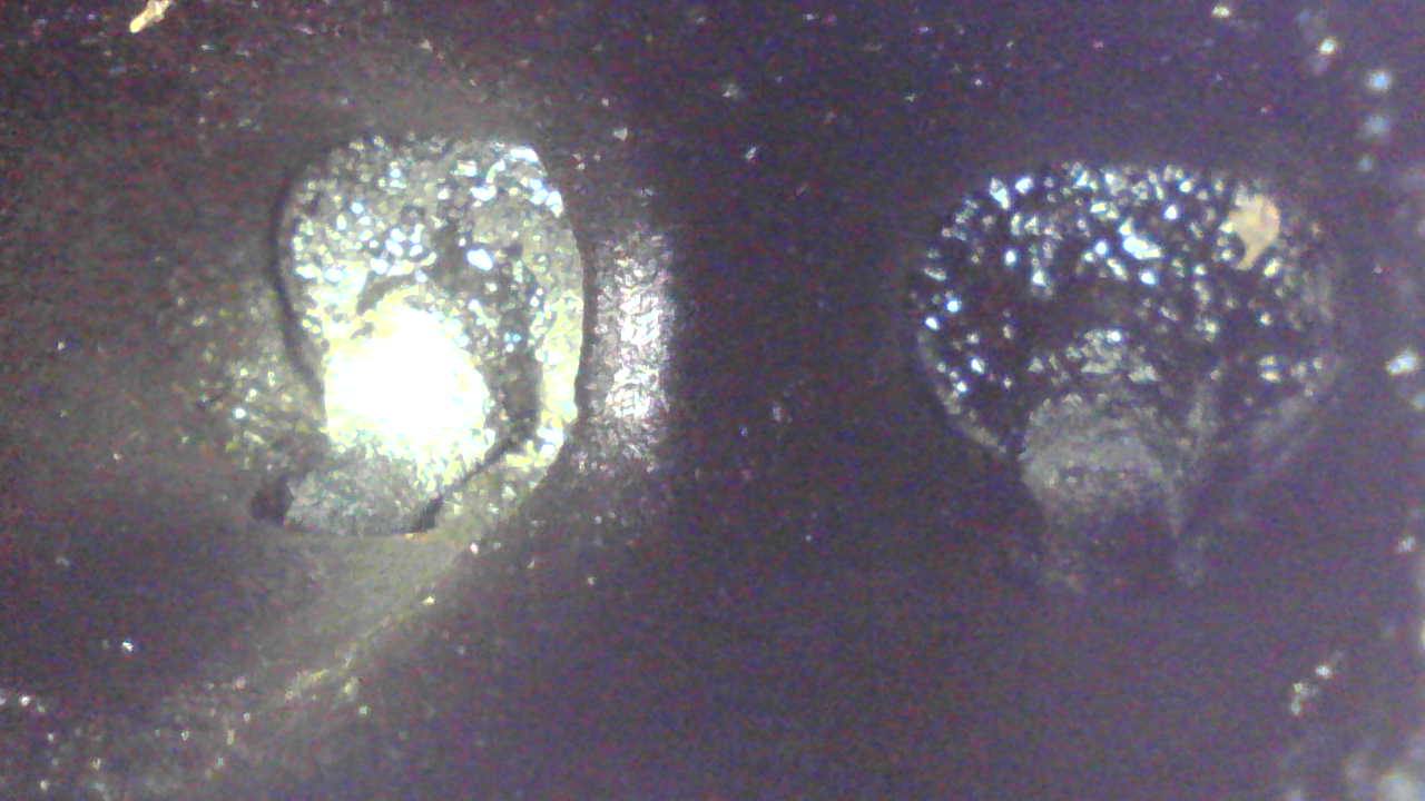

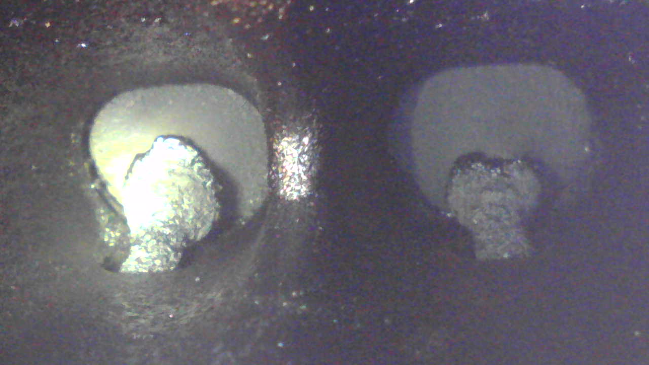

4 yr update. Now at about 71,000 miles & cleaned them again. It's amazing the difference this makes in driveability. Mine, with time, seems to develop a hesitation / stutter when you accelerate, especially from a stop & each time that has gone completely away after the cleaning.
Just a couple before / after pics for reference. This is with just about 30k miles...
Attached Thumbnails Cleaned my valves-20171203151409.jpg   Cleaned my valves-20171203151427.jpg   Cleaned my valves-20171203165333.jpg   Cleaned my valves-20171203165509.jpg

its incredible how much build up there is after less than 30k miles
