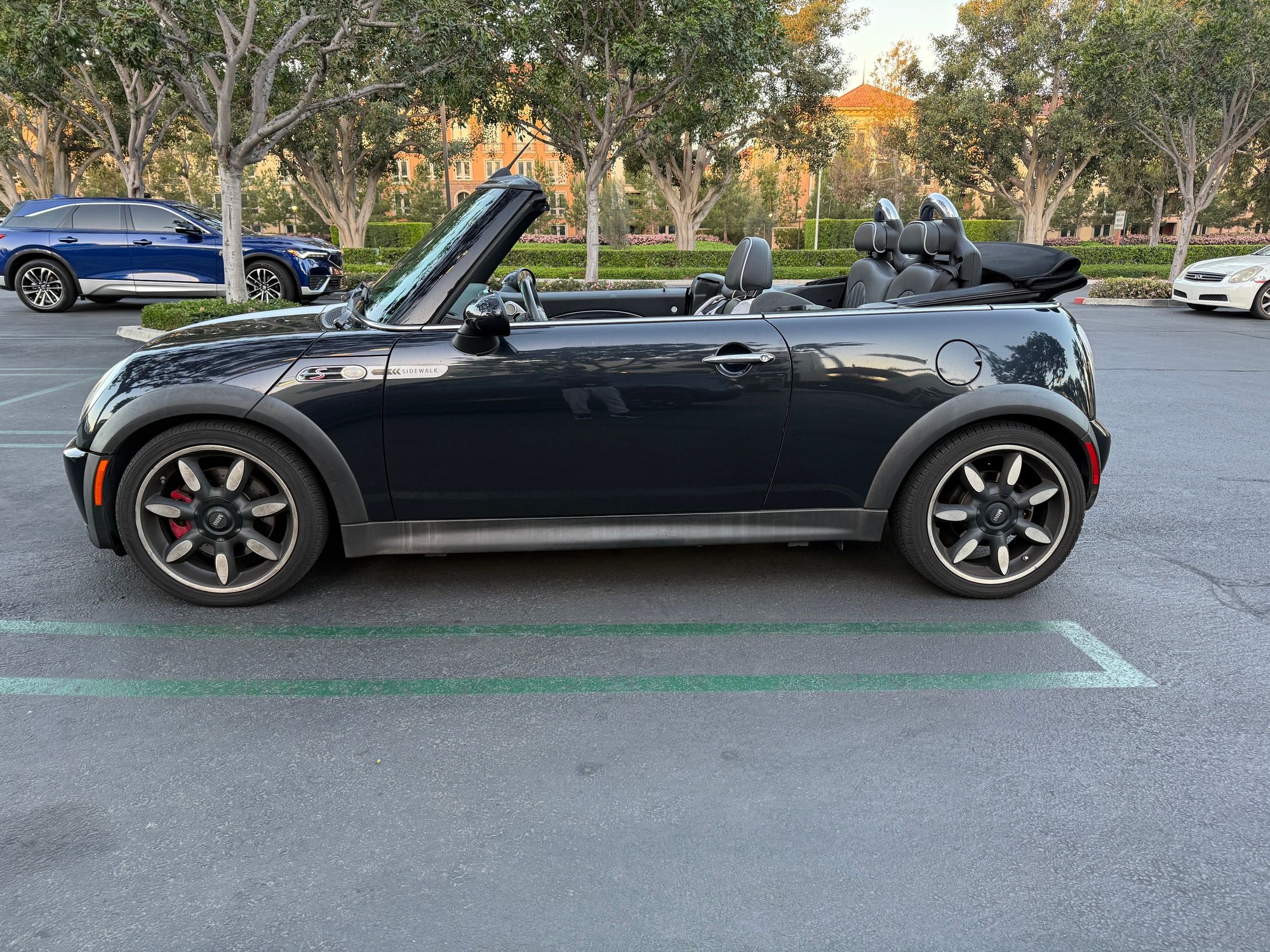

want to share my R52 project
2008 R52 sidewalk edition , automatic
car is being restored from the ground up , every piece ,nut or bolt will be upgraded ,painted or powder coated
all parts will be new or from low mile donors cars with 20k 30k 40k
R56 JCW brakes front and rear
R56 aluminum rear control arms
Bigger sway bars front and rear
poly bushings were needed but keeping the ride quality good for a street car
KONI yellows front and rear
H&R springs in green to match the car
M7 strut bar
ENGINE will have
light ported head , stock cam for street use
ported intake
Bigger TB 64mm
electric water pump conversion
550CC injectors to run e30/e50 tunes by nastase adrian
stock charger with 17% pulley
Front mount intercooler with AC , yes front mount with AC
Super sprint racing header
milltek catback exhaust
front mount oil cooler
front mount transmission cooler
front mount power steering cooler
BODY
JCW aero packge all around
18 inch JCW wheels
carbon scoop
carbon mirrors
carbon boot handle
carbon gas cap with r53 conversion
blacked out trimmings
aero grills
rally lights
INTERIOR will be simple , stock sidewalk seats
4 point roll bar with rear seat delete
Stewart Wagner steering mounted boost gauge and volt gauge
E85 % gauge mounted on corner pillar pod
double din radio with back up camera and upgraded sound system
Probably forgetting a few things but should be a very nice build once done ,
here are a few pictures .

wasn't like that before, i took everything off and left it in the frame , took it outside on dollies and pressure washed everything 3 times , then I painted everything like OEM and reassembled it back with low mile parts , here's a before pic
Old Mar 26, 2025 | 07:35 AM
Posts: 36,768
Likes: 2,553
Wow. Ok, it did look like it was from the north. lol
Great job.
