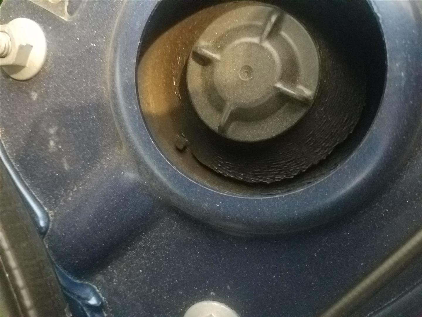

Looks like I have a cracked strut mount (passenger)? Attached is a pic. What's the best route to fix this and make the R52 better?

I went stock to avoid adding anymore harshness to the front end. It is pretty rough as stock. Since you are taking the struts apart it may be time for some Koni FSDs.

Originally Posted by PokerMunkee
Installed the Madness CAI this weekend. Had a WTF moment after I tried starting her back up and it didn't click over. Took a minute, but found I didn't fully connect the wiring harness for the ECU. Ooops. Started right up after that!
I like it, looks good and sounds great. Love hearing the S/C scream!
Tips here:
https://www.northamericanmotoring.co...ment-tips.html
Tips and parts here:
https://www.northamericanmotoring.co...-500miles.html
