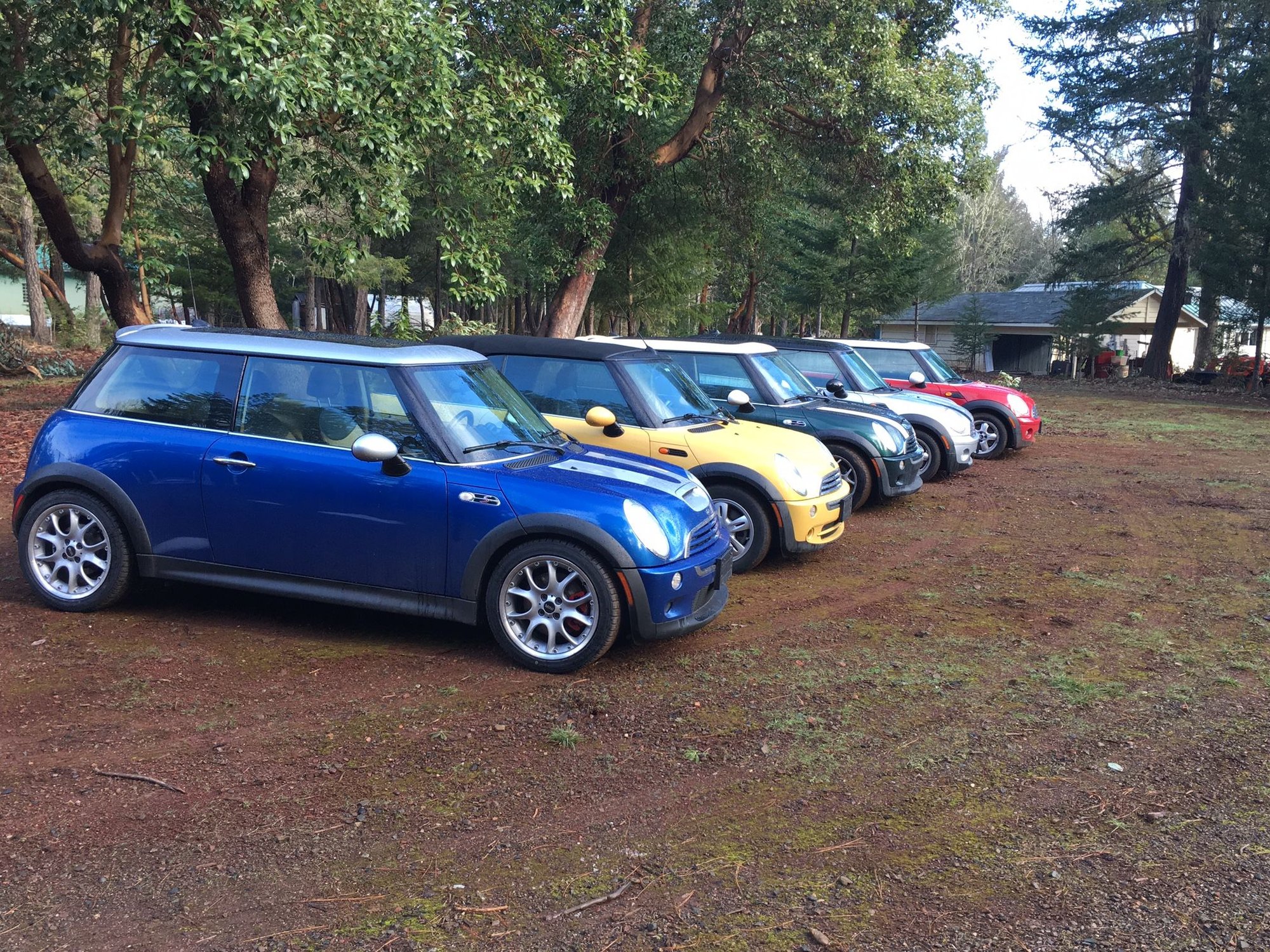

I am sorry, I have not driven one. I am a w11 R53 kinda guy, that likes the gen ones. I strive to keep them alive! My 06 Mini S JCW was always my goal for the perfect Mini.
The one in the foreground
I do have many others to choose from though! Second is my 05 Mini S in British Racing Green ( I am selling her, but she will always be one of my faves)

Hello Wayne. What a great stable of Mini's you have!
