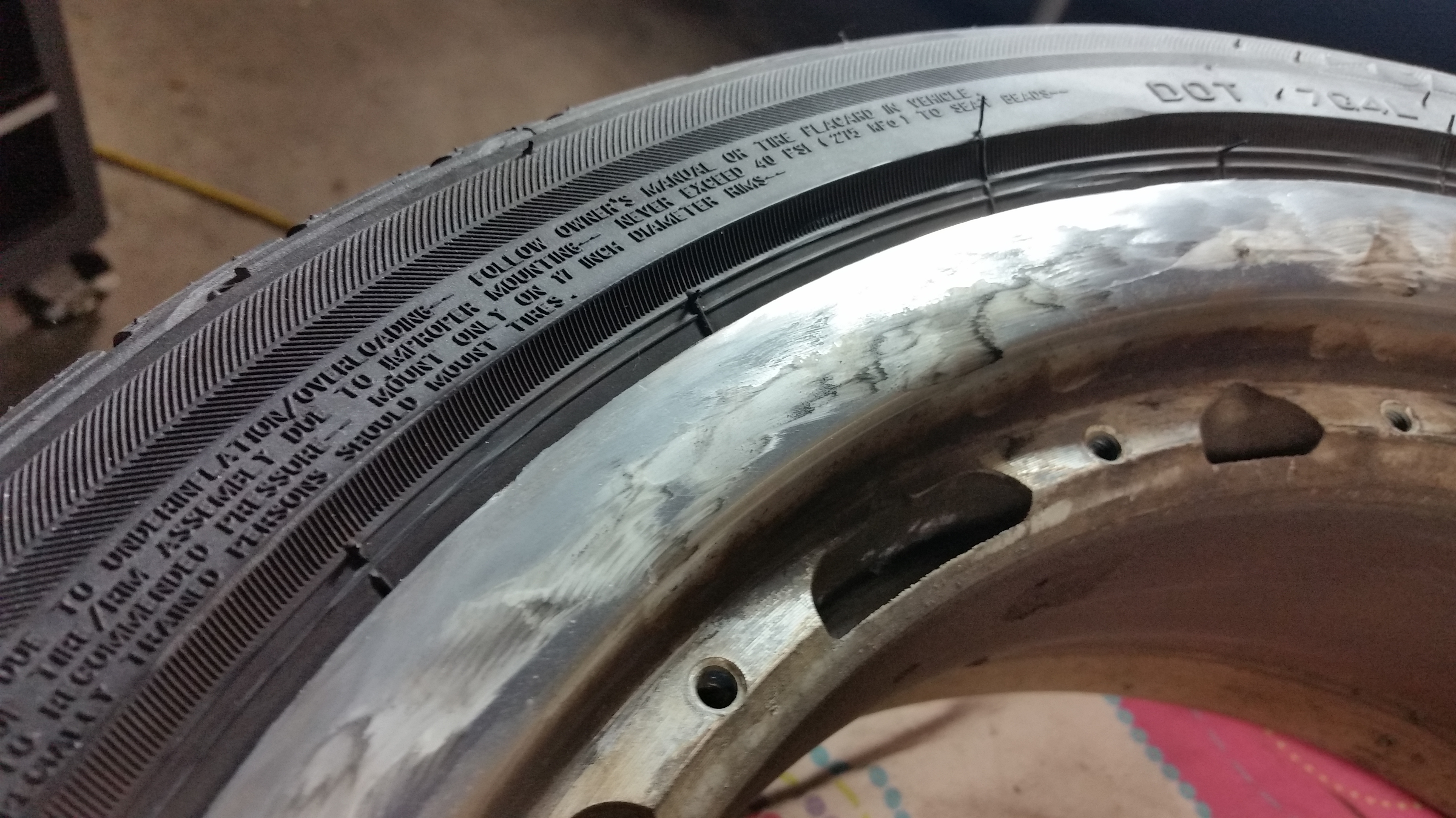

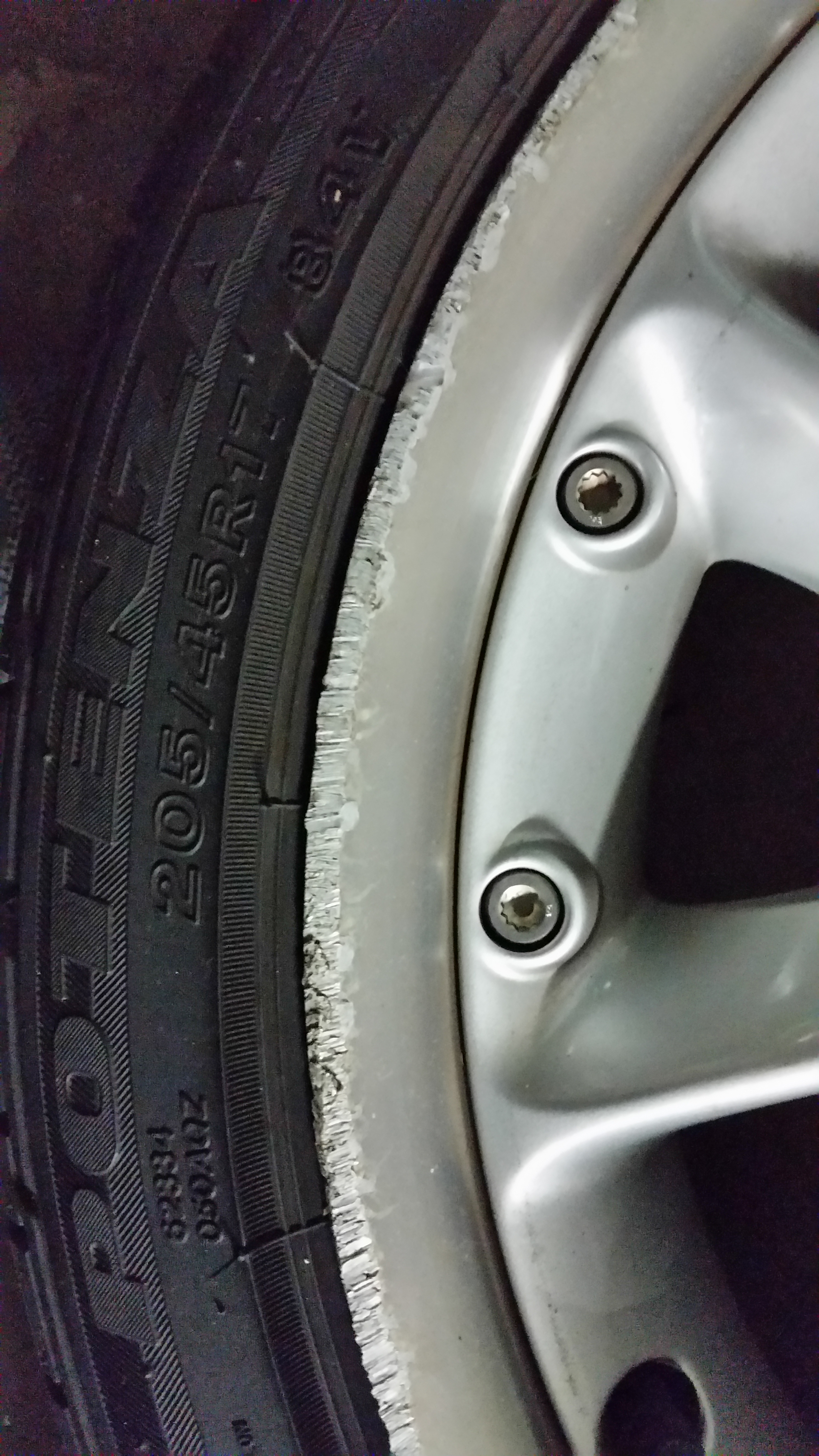

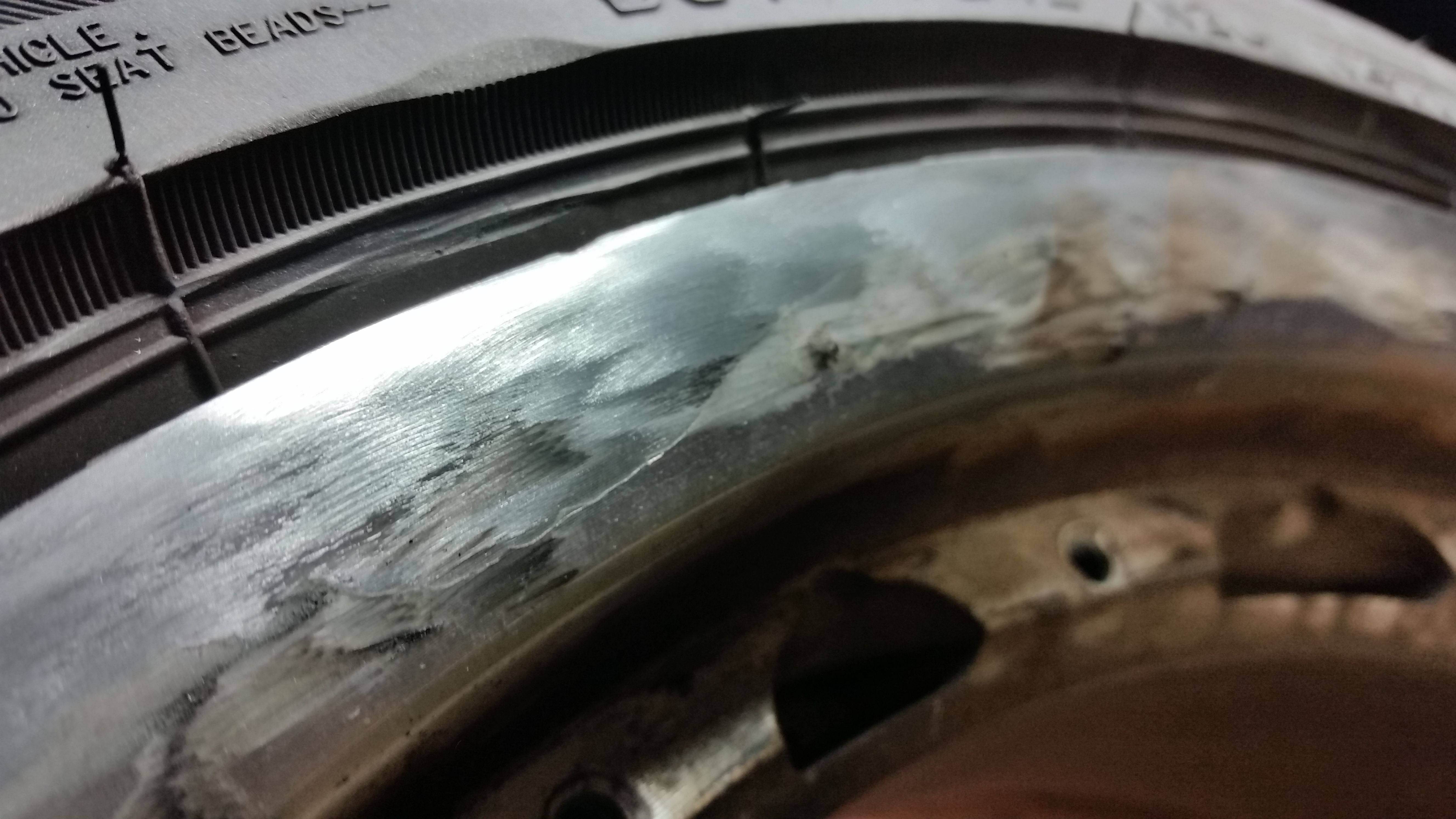

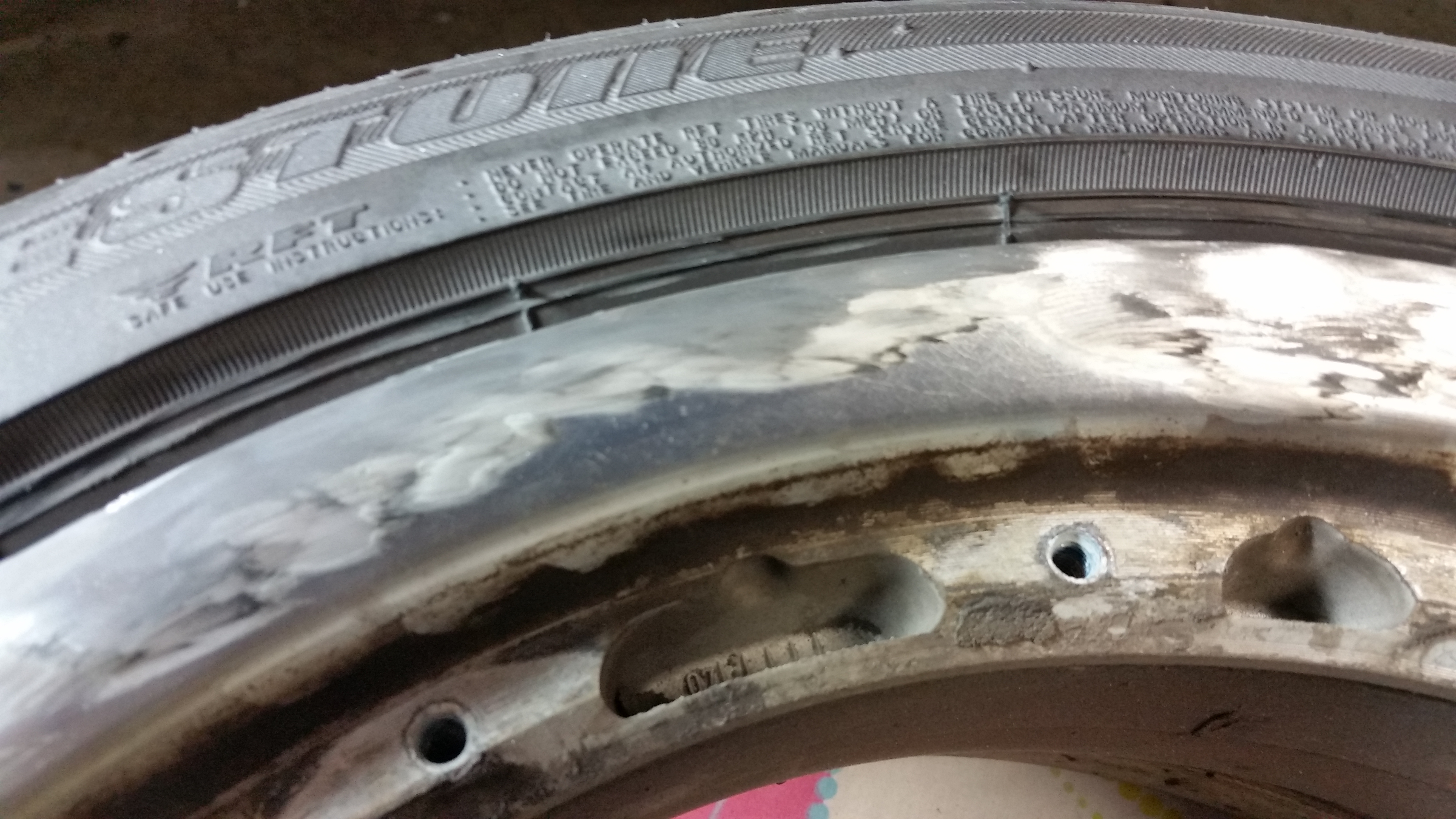

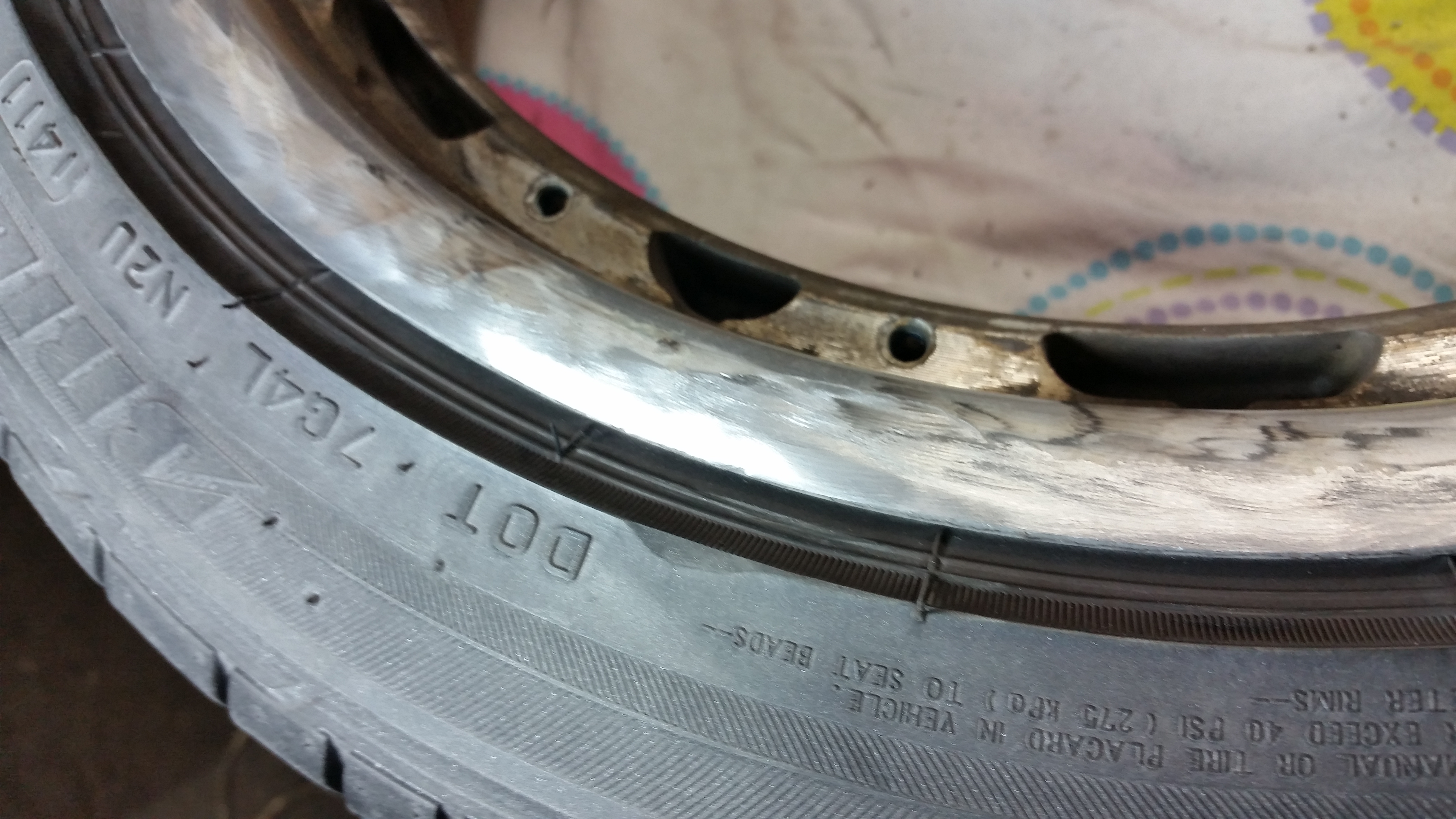

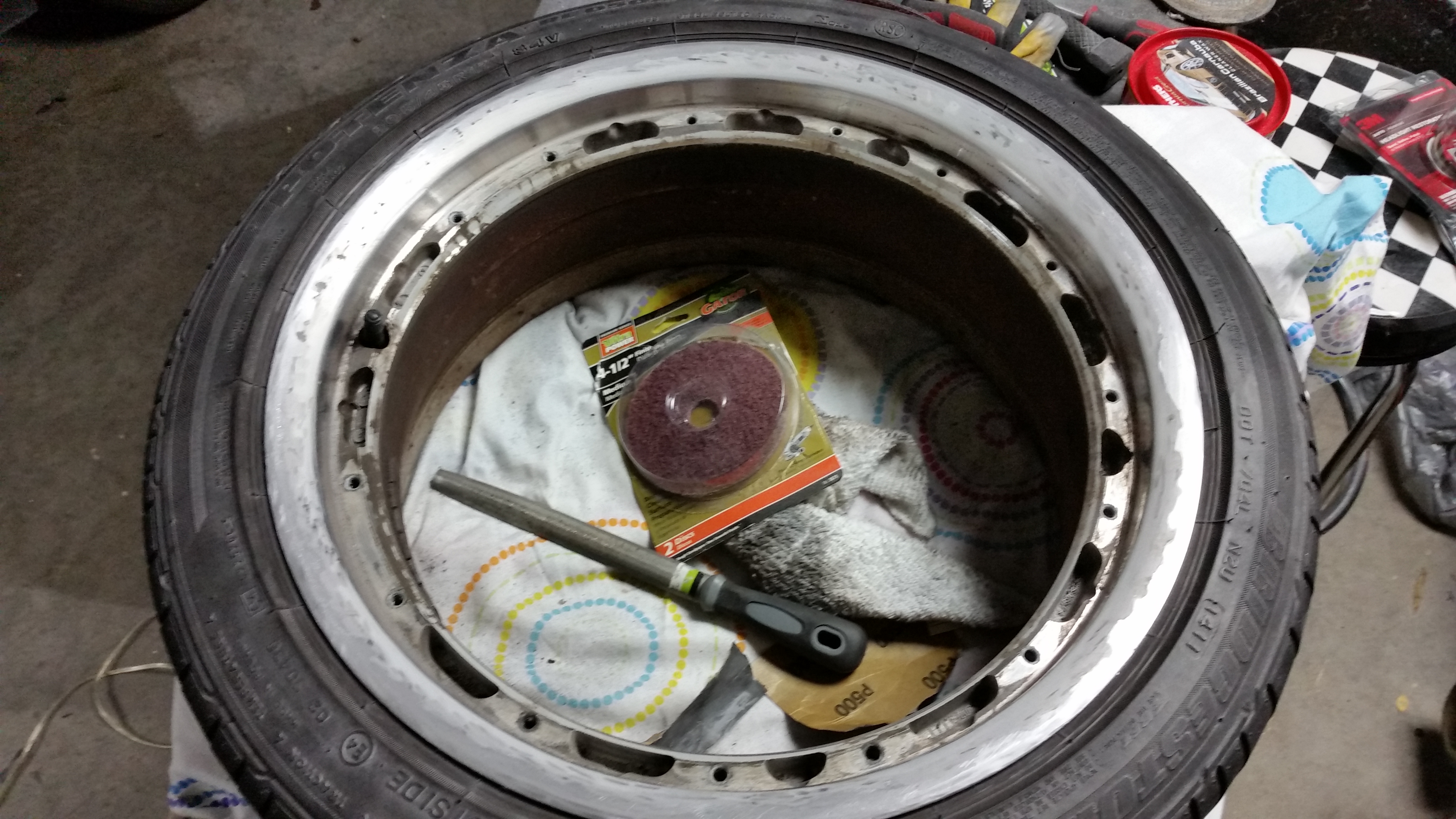

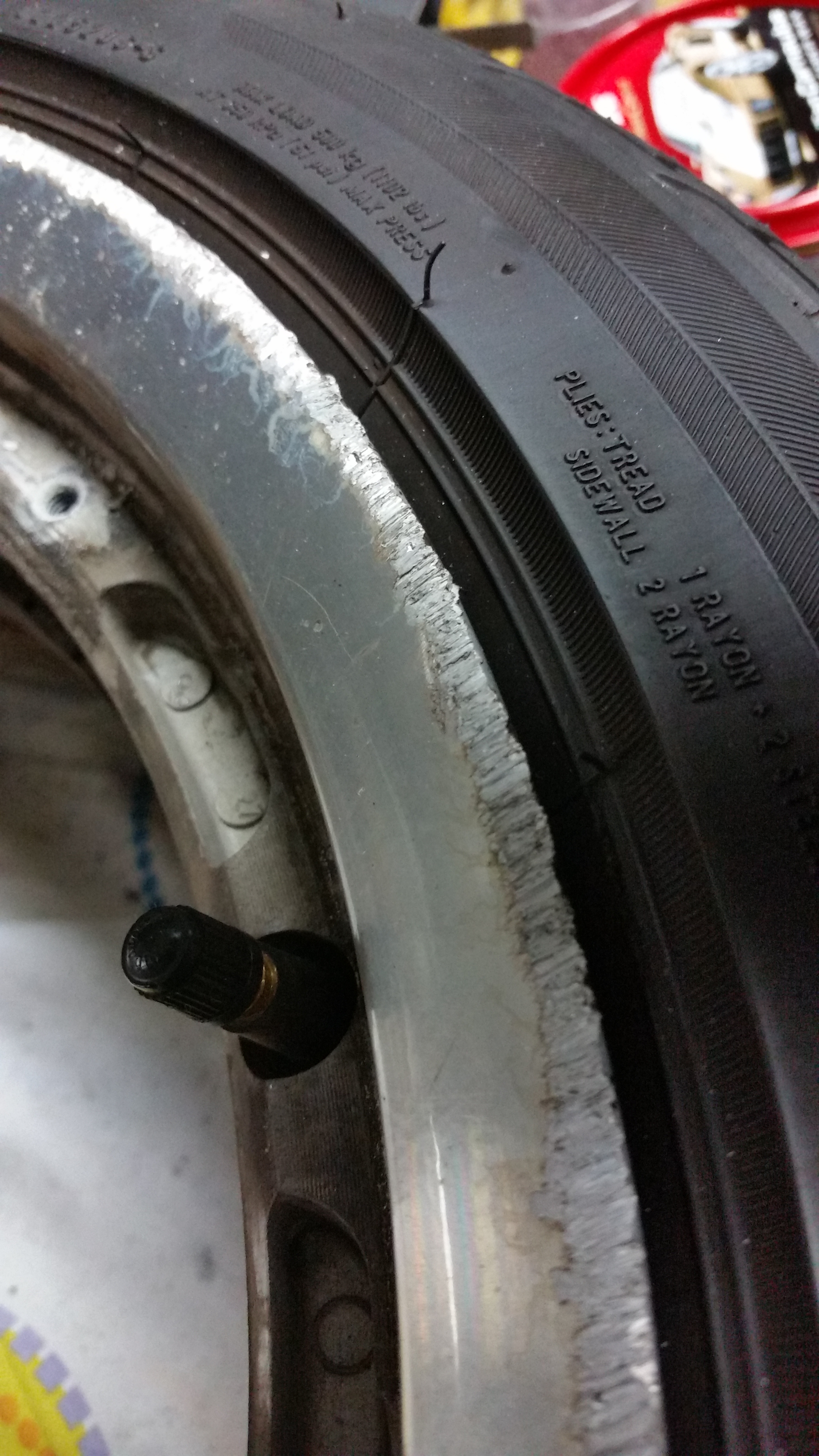

It only took 30 minutes achieve the results below. Now I just need to strip the clear coat, sand the wheels smooth, and give them a final polish:
BEFORE:
AFTER:

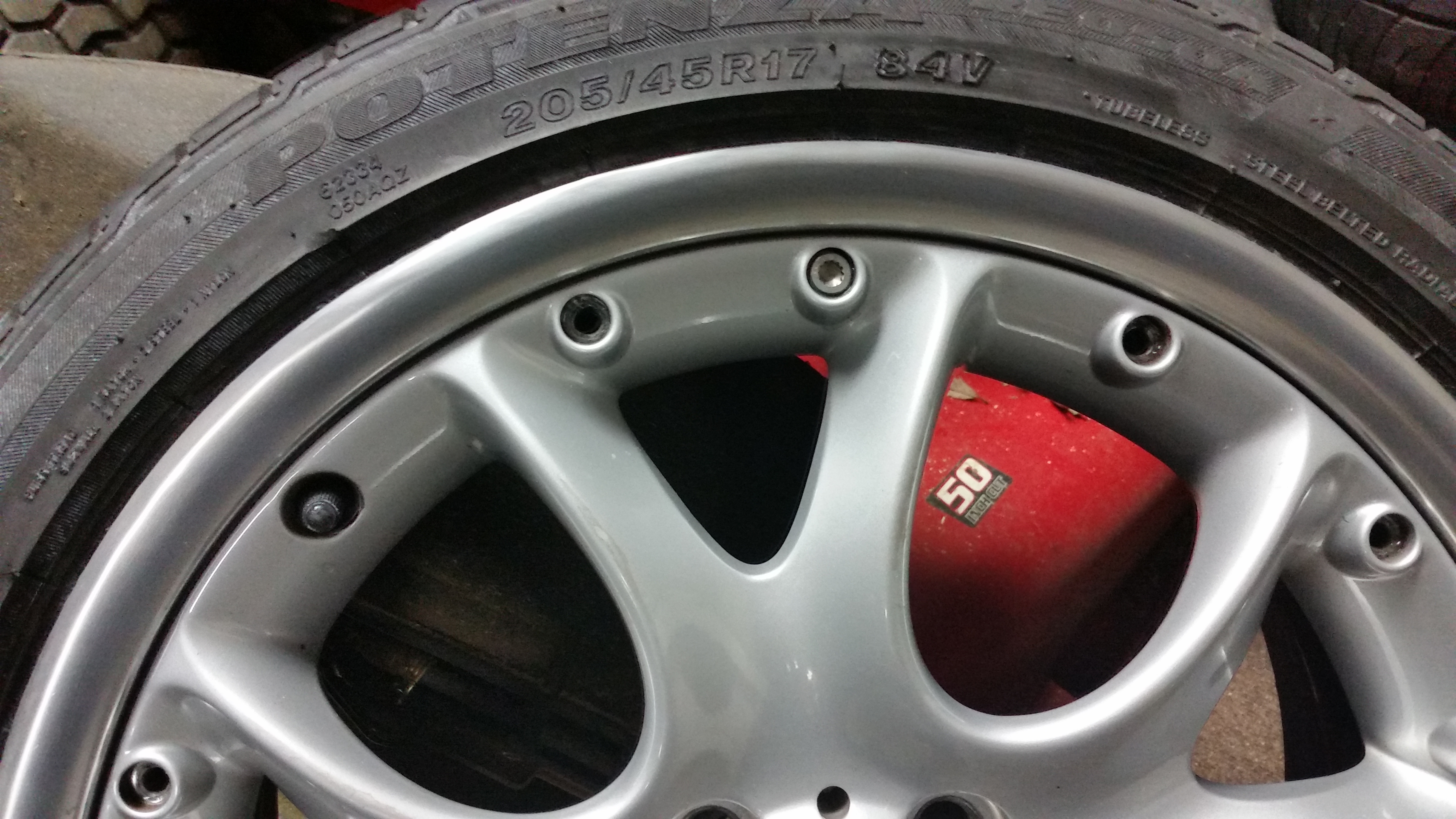

Wheel 3 is done.

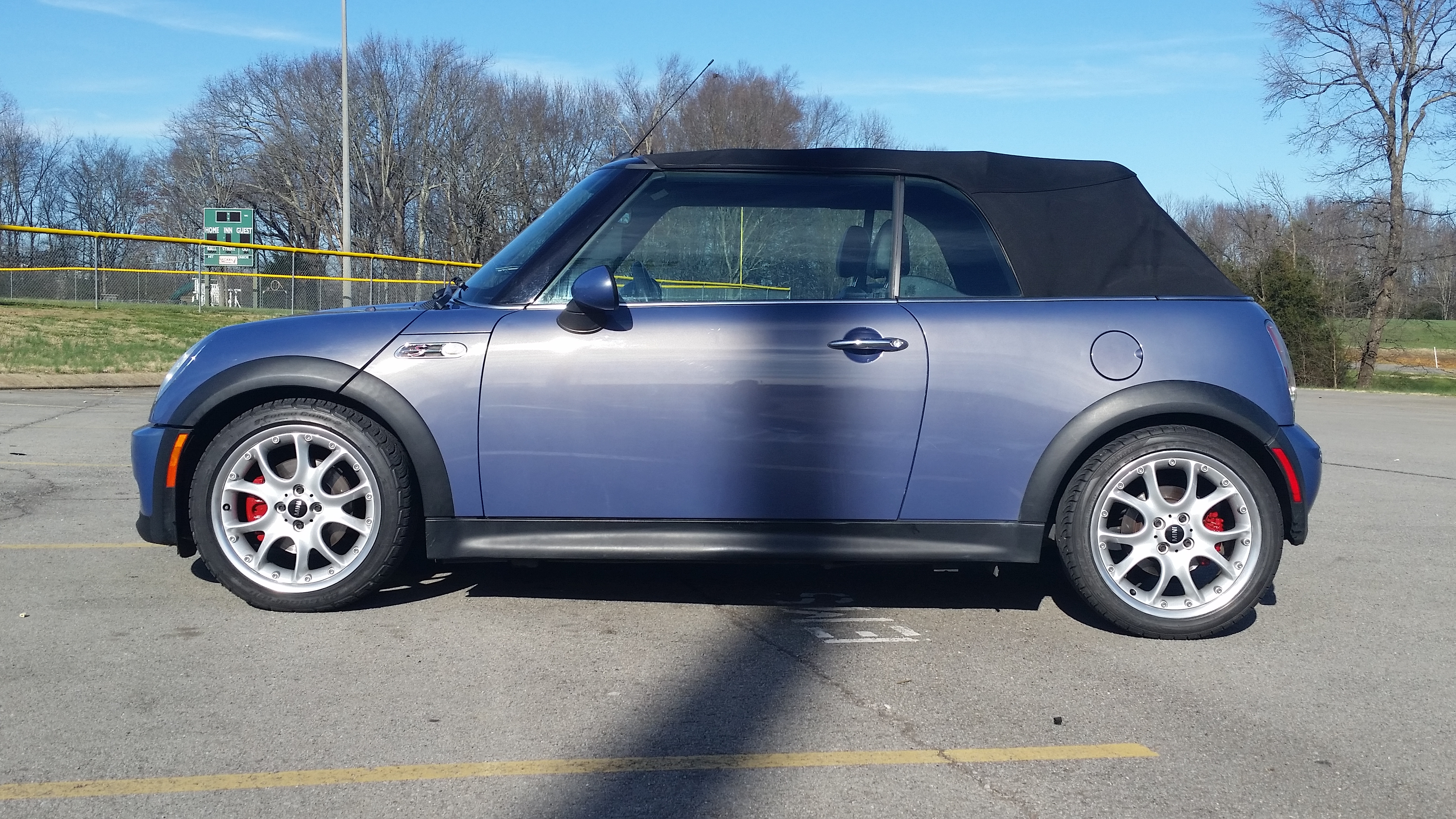

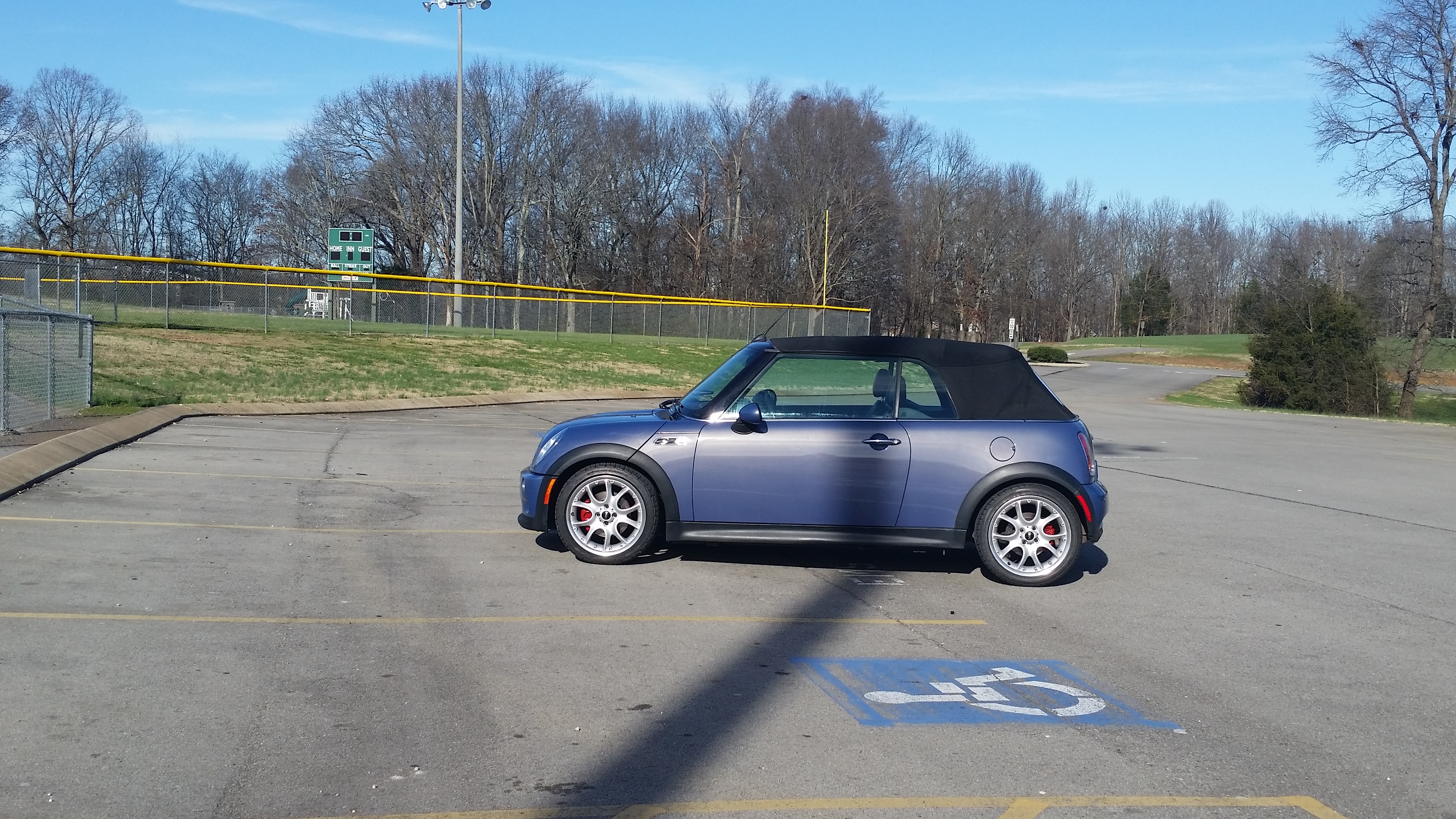

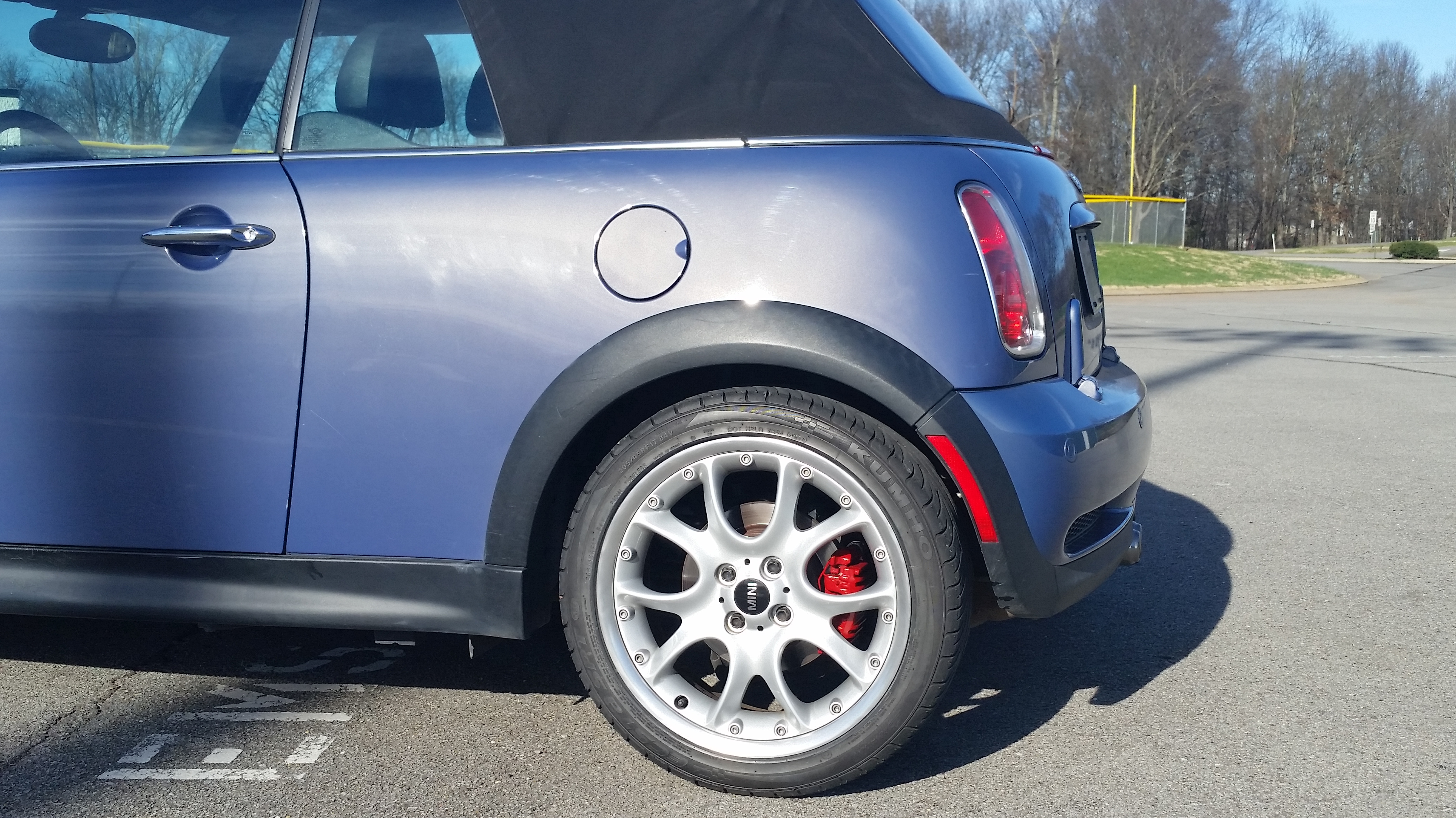

All four wheels have been repaired, reassembled, and reinstalled. I've also painted the calipers.

Thanks. I elevated the wheels on a table, so I had more control of the socket, and to save my back. I then carefully loosened them in a crisscross pattern. Once they were fairly loose, I used my 18V impact to back them out. Saved more time than you'd think.
The best method for milder damage was to use the grinder to level out the rash and call it a day. I used the epoxy to fill in the bad stuff, and sanded it smooth. I wore a dust mask and safety glasses.
Once they were smooth, I took them outside and applied paint stripper to the lip down to the bolt holes. I loosened up the clear coat with a plastic scraper. When you spray off the paint stripper and clear coat, make sure you spray a jet of water into each bolt hole to clean out debris. There will be lots of it from the sanding/grinding.
I flipped the wheels face down so the water would drain from the holes. Once dry, I placed the wheel back on the table and installed the bolts. Make sure you apply the loctite. I started the bolts by hand and used my impact to firm them up. Then I used a torque wrench to finish the job.
Hope that helps. I've seen the BAVmotors videos on youtube, so I'm very certain you didn't need all that detail. However, I mostly posted that for the regular Joe that comes along a couple years from now.

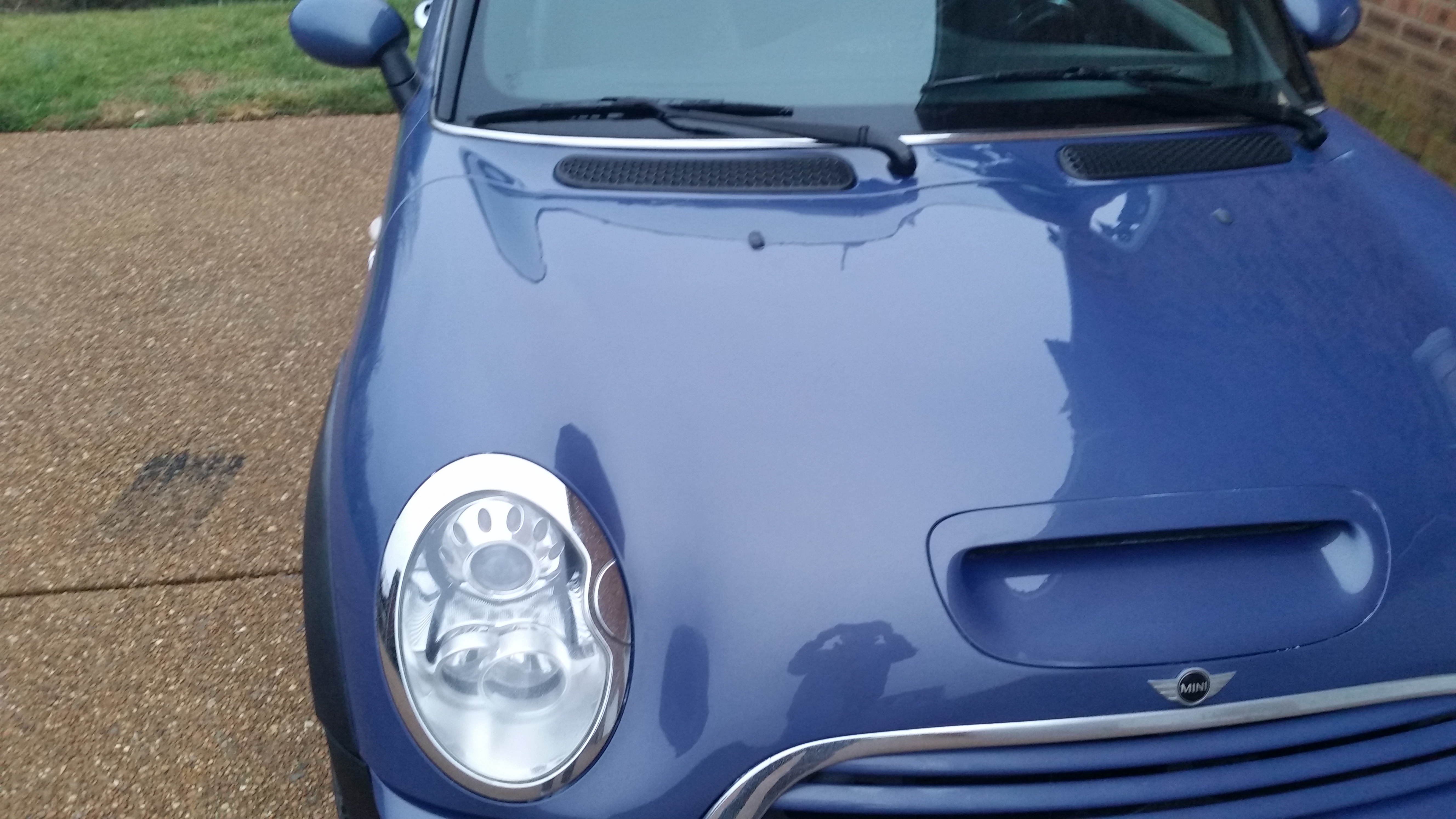

$550 down the drain, as I had the paint work down on Friday. Once the hand brake grip comes in the Mini will be complete. By the way, what's a fair asking price for it (2007 MC S R52) with 88K miles in excellent condition? It's a two owner car with a clean carfax. I'm thinking I'll be lucky to break even, but it's been fun nonetheless.
I was going to wait until spring to sell it, but I think I'll let it go this winter and pick up the lighter turbocharged 2007 hardtop for autocross. I'll be running against my buddies 1K WHP Porsche 993.
