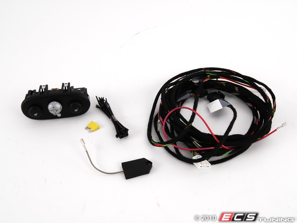

Check the fuse for the seat heaters in the fuse box, also check the plugs under the seats and at the switch button itself. If you have a the factory retrofit kit there is an inline fuse on the main wire harness. 61110145996

The fuse is good and all the connections (seats and switches) are fine. I'm pretty sure this was a factory install as it was a one female, dealer serviced car before I bought it a year ago.
I think I may try the "warmer seat adapter wire" that is mentioned in the link you included.

You are welcome, I had the warmer plugs added to mine and it very nice now. It was not that hot when i bought it new. I was used to heated seats from BMW's in the past that had heat at stage 5
