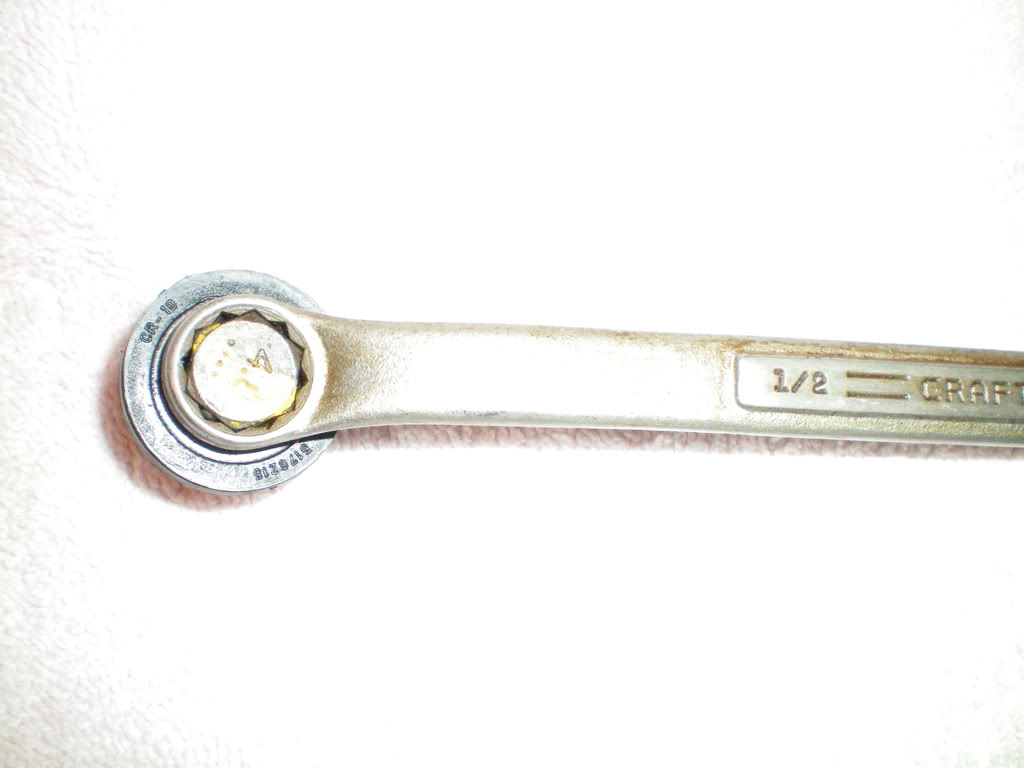

Hint (one of many buried in the million threads about oil changes)
contrary to what is written, the bung is a PERFECT 1/2 inch bolt size.
the recommended metric is a sloppy fit and as many have learned can result in trashing the head of the bung b4 you get it loose then requiring drastic measures to get it out.
