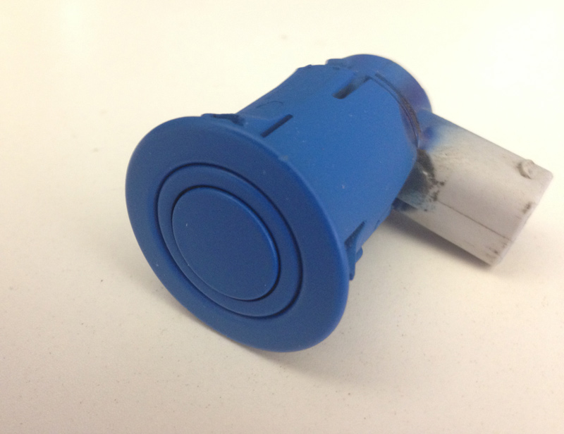

So my backup sensors have not worked since I first put the aero kit on 7 years ago. Totally removed them from the bumper even with no problem, no beeping, etc.
Just this week the beep has decided to come back when I put the car in reverse.
Is there a way (fuse?) to just completely disable this thing?

You can pull the fuse. The back up sensor ( PDC ) can get water in them , when they work they make a high pitch clicking sound. When you put you ear near them and you dont here the click while in reverse, its bad. When one fails , you get the long beeeep. In stead of short beep confirming your in reverse and the PDC is working.
Most likely the sensor sat in the sun , dried out a bit and started working again. But once water get into it again they don't work and you will get the long beeeep when you put it into reverse , they are color coded and ordered to body color. There are plain black ones also non painted that will work, but you will have the black dots. 4 in the rear bumper.

Thanks. I'll pull the fuse. My rear bumper is sensor free! (I have one on my desk at work actually)
Just thought it was strange it decided to start beeping again after so long, for no reason.

Yea, I had it happen to an R52 also. Bet its had water in it, then it dried out in the sun, started working again, I had one do that only and off during the summer. Just needed replaced and gtg.

Also, you can check to see which one is failing by putting the car in revers with the key in the first position and listening to each one. You should hear them making noise.
